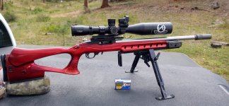

My rifle.. McGowen match barrel and factory action. Taken before the rotary safety install.
Assume you are asking me? I run Athlon optics with my fave being the Helos BTR Gen2 6-24X56 FFP Mil. Pictured on the Red rifle is likely an Ares ETR 4.5-30X56... I ran these for a few years but have switched to the Helos now
For the tuner, a tuna can is on both rifles. I use other options including muzzle brakes and stuff I make up. Full size Tuna can has enough weight to affect the typical 0.9 to 1" barrel. Well made and easy to use.
