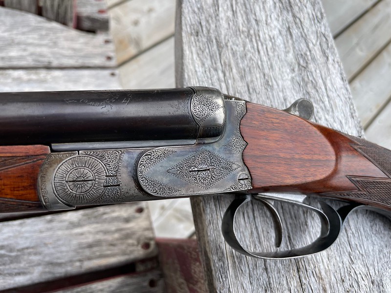

Aside from the English guns on the Intersurplus site between $1200 and $4000, I've bought two 16 gauge guns from Intersurplus in the last 3 months. Both pre WWII, very high quality, great bores (despite what the listing said) and I paid less than $400 for each, delivered with a money back guarantee if I didn't like them for any reason. My gunsmith is refinishing the wood and putting a new pad on one and the barrel bluing was already in great condition. For less than $1200 all in, I'll end up with a very nice, high quality 16 gauge in great condition. Once that gun is back, the other will go for the same treatment.
Here's one I did last year on the same program:
