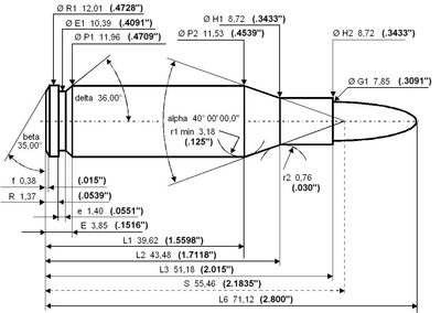

While I can't recommend it, I just looked up the dimesions of each case in the Modern Reloading 2nd Edition manual and they are surprisingly similiar. The case length is the most drastic difference and that is pretty much all in the neck which wouldn't make that much of an issue I would think. If they were sized properly, it appears as though it may be plausable. Comments in reference to the case dimensions are appreciated. Has anyone else done this?
The x54R headspaces on the rim. The 308 has no rim.
