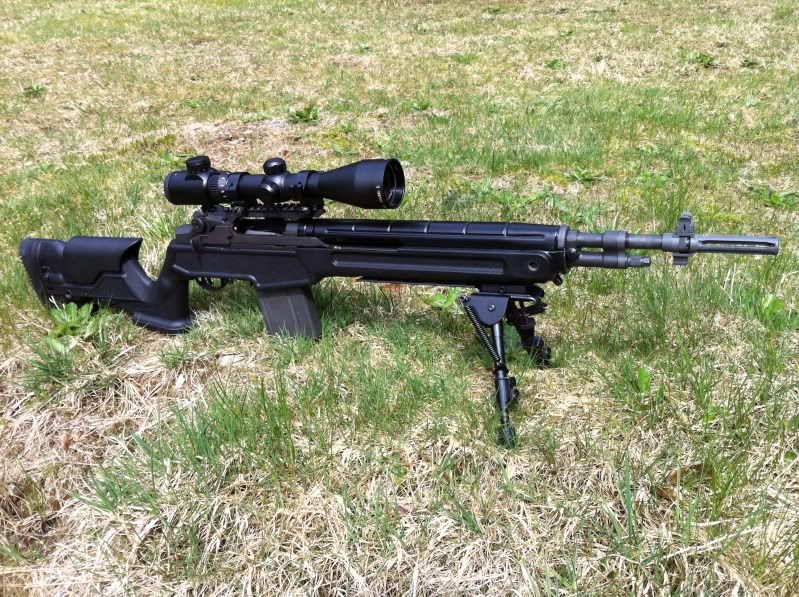

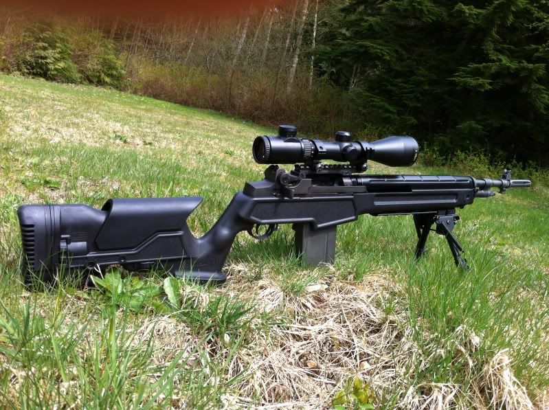

The Archangel at around 350 bucks gets you an adjustable stock that can be built around, providing your into weight lifting (mines 14 lb 6 oz with an empty mag)
My chop job on the Norc stock comes in at 9lb all up..........and Im seriously considering get rid of the Archangel unless I can find a set of wheels for it :)
I noticed an improvement in accuracy from the archangel right away! Now I don't know if that was from the tighter fit? Or combo of cheekriser and comfort letting me shoot better? But a definite improvement over the norc stock!
