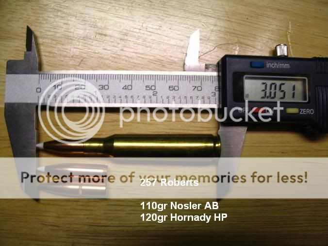

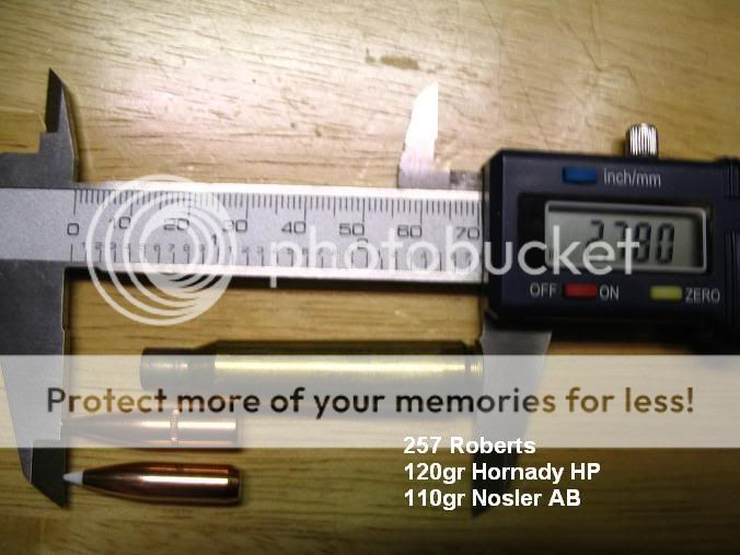

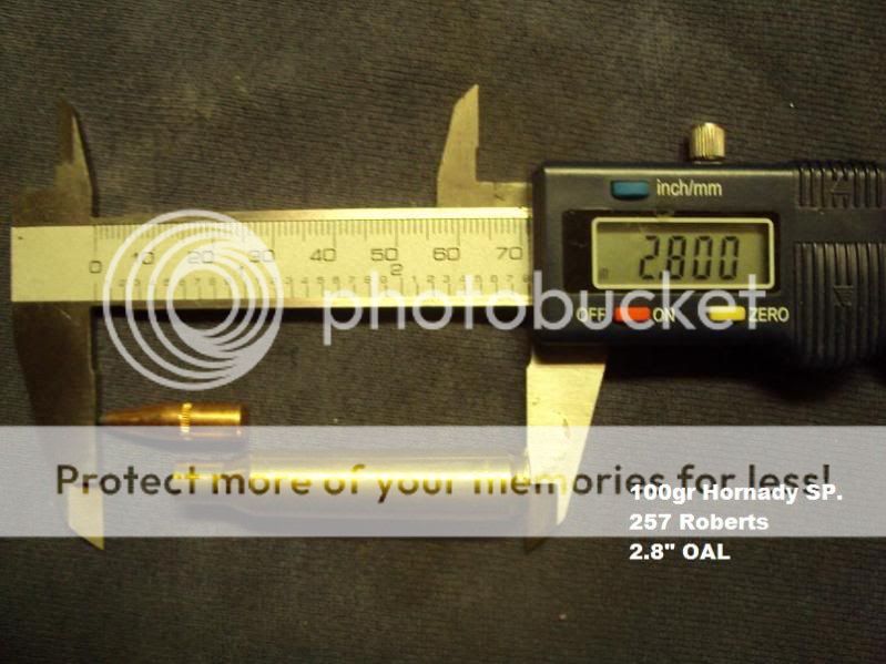

Advantage of the .25 is ability to handle heavier bullets than the .243 for deer sized game. I even shot a moose with one. That precludes selecting a barrel with fast enough twist. This was a drawback on some of the 250-300's. The 257 will handle up to .125Gr.
Correct ..... 2.8" is about max in a short action. I had mine built by Bevan King on a 700 long action.You need to be careful with this one though, especially when handloading. In a short action you have to seat pretty far into the case with anything over 100 gr. in order for things to feed properly from the magazine (my kimber Montana and a win model 70 I had were both this way). If you're only going to be able to push a 100gr bullet fast you may as well stick with a .243. My Ruger 77mk2 is a long action - and I can seat 117gr sst's long enough to be nipping on the heels of a .25-06. You could load heavy bullets in a short action but you'll limit powder volume. You mileage may vary but that's been my experience so far.
