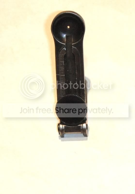

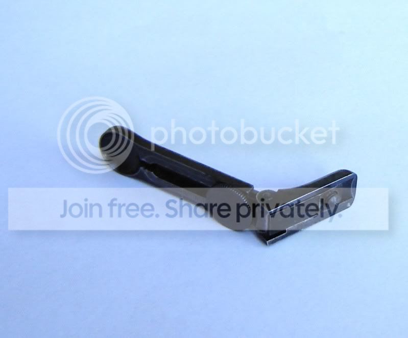

I think this is a lyman tang sight, but no markings to show, only marks are under base which are DA which I believe to be (D) for winchester 94) and A for the locking arm. I if have that correct? So is this a Lyman or Marbles? Thanks.
Road King got the rifle designation correct but it's not a 2A, it's a 1A.
A 2A would have a stem that you can screw an aperture into, the 1A has a fold down peep attached in the stem itself and I believe I can see the flip down peep on the far side of that pic.
I love old sights more than I do the guns they go on!
Wow, Boone sights. You don't see those everyday! Hard to find just one. Nice collection.

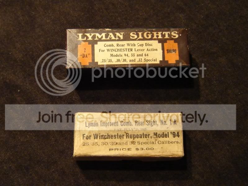

On the Lyman 1A sight, it is the A in the 1A which denotes the addition of the locking lever. However, the code DA on underside of the base is the code for the Winchester 1894 (94) in .25/35, .30/30 (30WCF) & .32 Special calibers, the Model 53 in .25/20 & .32/20 calibers, the Model 55, .30/30 caliber, and Models 64 & 65. Lyman tang sights for the 1894 (94) in 38-55 and 32-40 and the Model 1892 are marked with only a D.
Matt
Matt, thats right, the A denotes the locking lever on the side opposed to the old style Lyman with the round spring on the side. On my sights, the second row furthest to the left would be just a Lyman 2 as it has a screw in aperture and no lever lock. The one underneath it would be a Lyman tang sight as well but it wouldn't have either a 1 or a 2 as they were made for Savage and have neither the spring or the locking lever, they were known as Savage #18 or #19's.
Nice boxes RK. I will post pics of my sight collection when I get back home after the holidays. I have a lot NIB, also a couple Marbles sight trees which are very rare, and a neat thing to see if you have not seen one before. They were given to sales representatives to take to stores to show retailers what the company offered in varied types of sights, including front sights, apertures, tang sights, receiver sights, etc. The boxes for some of the old sights are pretty neat too. As I am into Winchesters, all mine are for Winchester rifles, with the exception of a few of the items on the sight trees.

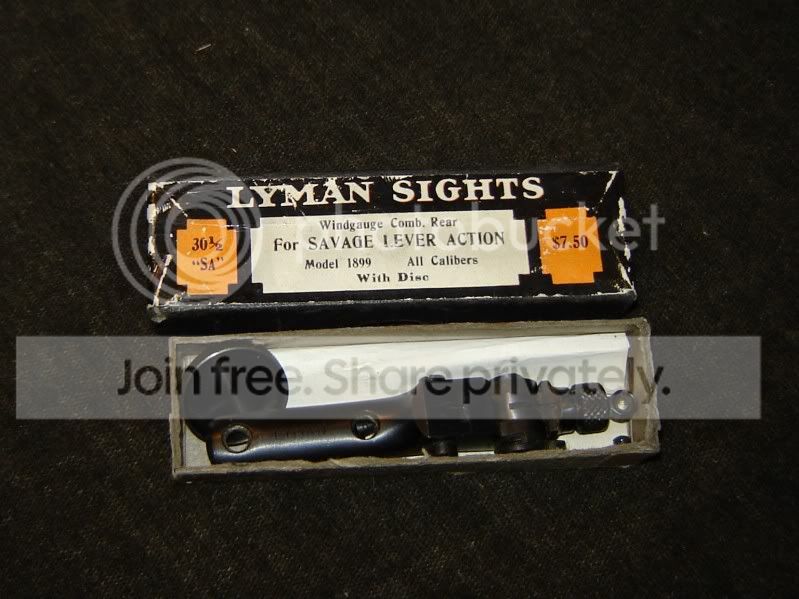

I've got a NOS 30 1/2 as well. Or is it the 31 1/2? Hmmm, pretty sure it's a 30 1/2, same as RK's. Have to look when I get home.

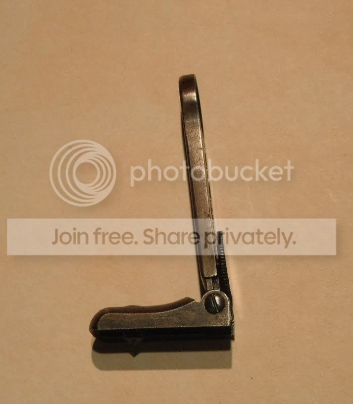

Found this sight a few weeks ago in a junk box at a gun show. This Winchester Model 62B is likely the rarest Winchester tang sight to be found. Made only for the model 1873
There was also 1/2 dozen Watson globe front sights in the box.
Road King, if he had a half dozen Watson globes in the box I can take an educated guess as to who's table it was at, was his name Paul?

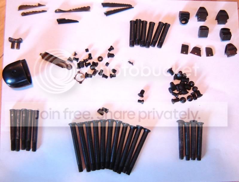

No these were not on a table but a guy just brought a bunch of books and some old parts in to sell. He couldn't get $20.00 for the stuff and I really didn't need 10 years of Man of Arms magazines and some plastic bag with a bunch of rusty screws and bits and pcs of stuff that I really didn't have time to go through. After a while he came back to my table and asked me if I would give $10.00 for the books and stuff. So what the heck I said yes.
The tang sight was all in pcs so it really didn't look like a sight, but I did reconize the eye pc as from a 62B sight. So I kept digging and found the rest of it. Called him the next day and went and found the spring that was missing in some more junk that he had and ended up with all the stuff in the picture below. Never know what you will find at Ontario Gun Shows. ;)
