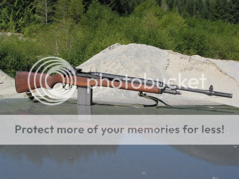

Here's mine with a polyurethane finish on a GI walnut stock. Probably 10 coats of poly, then I used automotive finishing compound to give it a high gloss.
Came out much nicer than the picture suggests. Next time I go to the range I'll get you a pic in the sun.

This looks interesting (I appreciate fine wood)! Please provide a better image, and please reduce your image size.

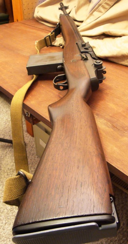

Ok, I finally got around to finishing the stock. I took into thought every ones contributions so I decided to basically do all of it.
I cleaned the stock, then used a stain, BLO Turp mix.
I rubbed it into the stock like a madman.
Once it all dried I then put on about 4 coats of tung oil. It was a bit shiny at first so I took some steel wool and brought it down a bit.
So now I have a pretty tough finish but that still have a bit of milsurp look to it.
Curious what you think
Very nice! I like it. You can't go wrong with Tung oil.
