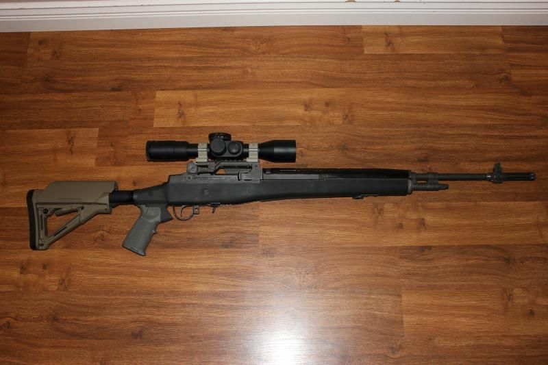

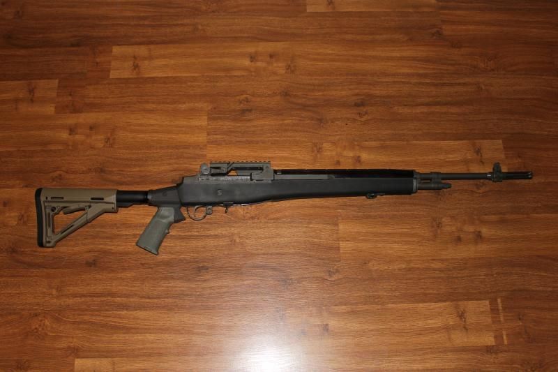

It is lighter than the original stock now as the metal butt plate alone on the original stock weighs a lot .

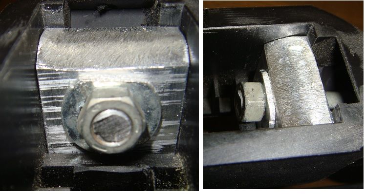

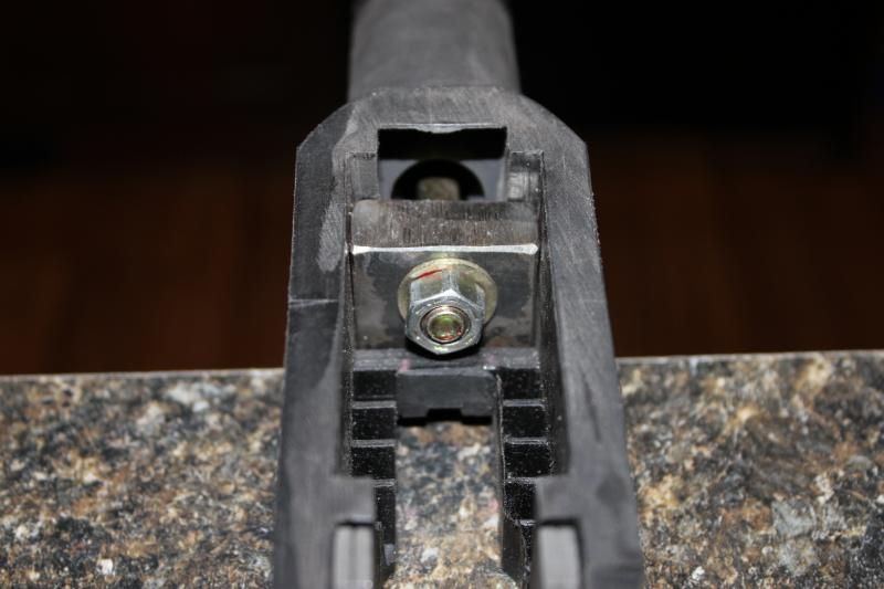

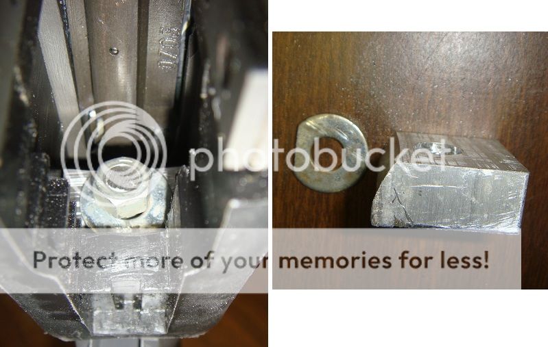

do you epoxy the wood block in place or is it just held by the bolt?
Easy to see in the pic when compared to the final product.

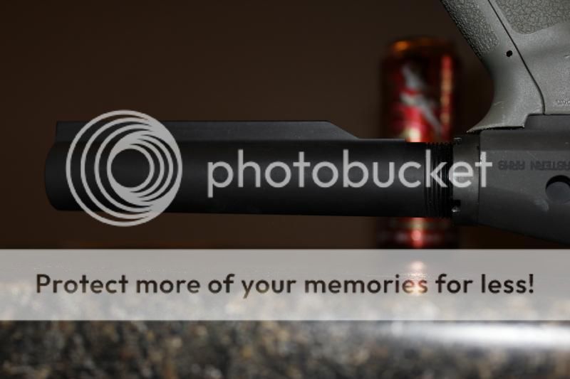

Well I was able to get to my build this week. After a couple of days in my companies shop (they have a bandsaw and the piece of steel needed) I cut my stock and thought I had it cut on the right angle. After getting home I put it together and saw that it was out by more than 3mm measuring the front and back of the buffer tubeEasy to see in the pic when compared to the final product.
So this morning I hit the stock with a file. It took some time to get the angle right. Having to file a bit, them remove to see how much more was needed. After an hour or so I got it close enough to call it good (.3mm out overall from the front to the back of the tube)
I bit of 246 red locktite to make the bolt solid and we'll call it a day.
