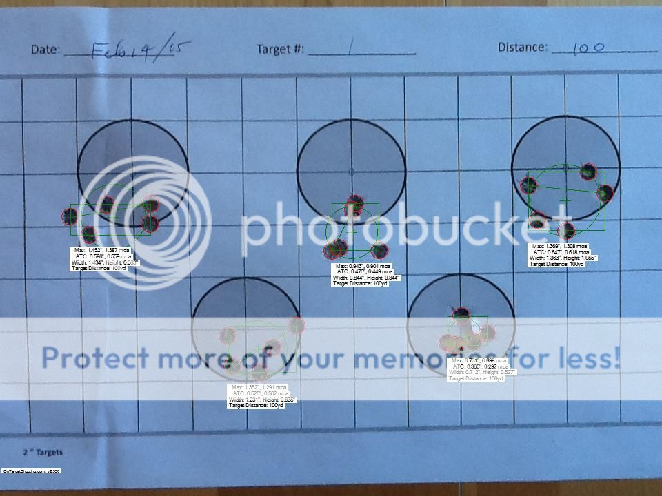

To revive this thread a little I'm upgrading my 1.5 MOA Challenge result (see post #139). Haven't shot the M305 much since the Fall having been distracted by a new AR but took her for a spin today even though the conditions were frigid. The last tweak was bedding the heel of the receiver into the Blackfeather stock. After 5 warm up shots on a different target with Norinco bulk, I switched to this target using my ol' regular load of 39.5 grains of 3031 under a 168 BTHP.
Net results, Average 1.169" (1.117 MOA), max group size 1.452" (1.387 MOA), min group size 0.731" (0.698 MOA). As Tony has said, these are getting too easy. Will definitely have to take out to the 200 yard line.
