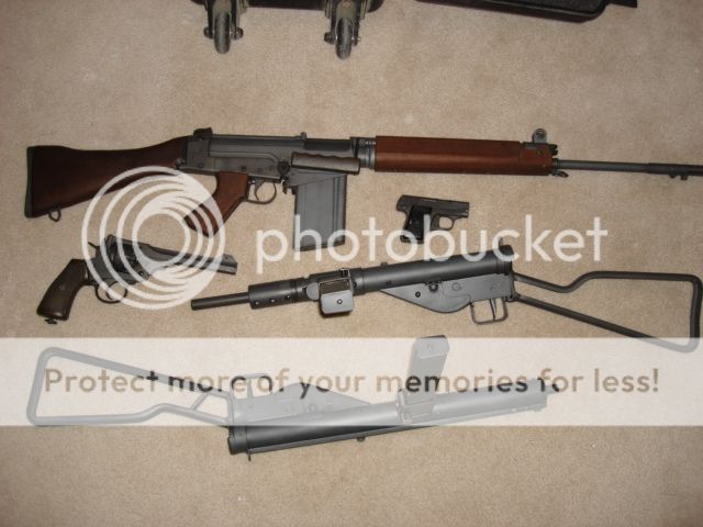

Thanks for the advice I will try both methods once I get my hands on it again. As for originality I am also doing a couple of stens, FNs, and some handguns. All have a poor finish and I am more interested in enjoying them now than what they may be worth when my kids deactivate them. Thanks for the input however.
