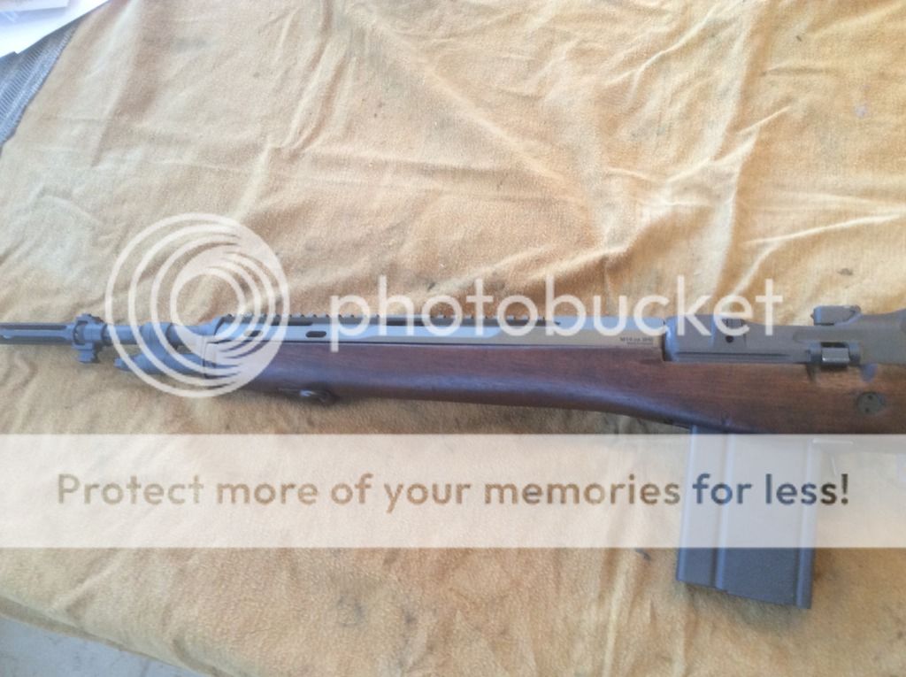

New to the gun game, but after going back and forth between wood and synthetic, I got a Boyd's walnut stock for my M305. After some minor fitting and refinishing with pure tung oil, I am so glad I settled on wood. The rifle is beautiful! It is also pretty heavy, but I'm not complaining. (Photo was before refinishing)
I bought the stock liner, liner screws, upper wood screw, rear swivel and ferrule (USGI) from treelinem14.com. I used JB Weld to fasten the ferrule, and reused the Norinco butt plate (tight fit, if I'm being honest it took some "persuasion" with a rubber mallet). I reused the Norinco forward sling swivel (in conjunction with M14 M1A Sadlak Front Rail Mount HD) and destroyed the original Norinco rivets getting it off, which I now realize was stupid, because I have ruined the resale value of the original stock. If I could go back I would have bought ALL new USGI hardware, but what can I say? I was excited about my new (and first) rifle being how I wanted it. Lesson learned there.
Edit: Just realized I never directly answered the question, to wit: No, the Boyd's stock came with no metal hardware.

How much of the norinco hardware can transfer over to the Boyd's stock (without filing and tinkering etc.) or does every piece have to be fitted?
gorgeous, nice photo.
nuthin quite like good ol steel and wood when it comes to the M14 types and Garands.
