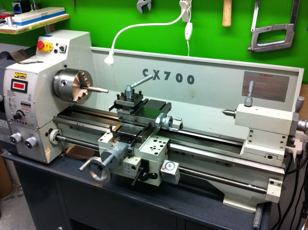

Well, I did it. Picked up a Craftex C700 10x22 lathe from Busy Bee in Ottawa. Managed to get it into the garage with the help of my neighbor. Don't think I abused my back but will know when I wake up tomorrow morning!
Got to buy some de-greaser tomorrow as it is covered with gunk. I am pleased with the purchase and look forward to making chips.

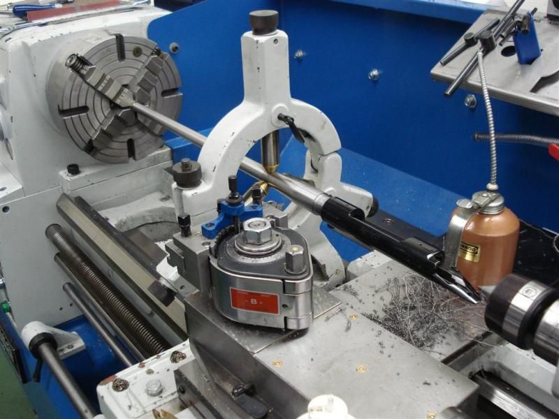

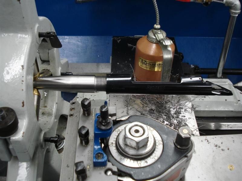

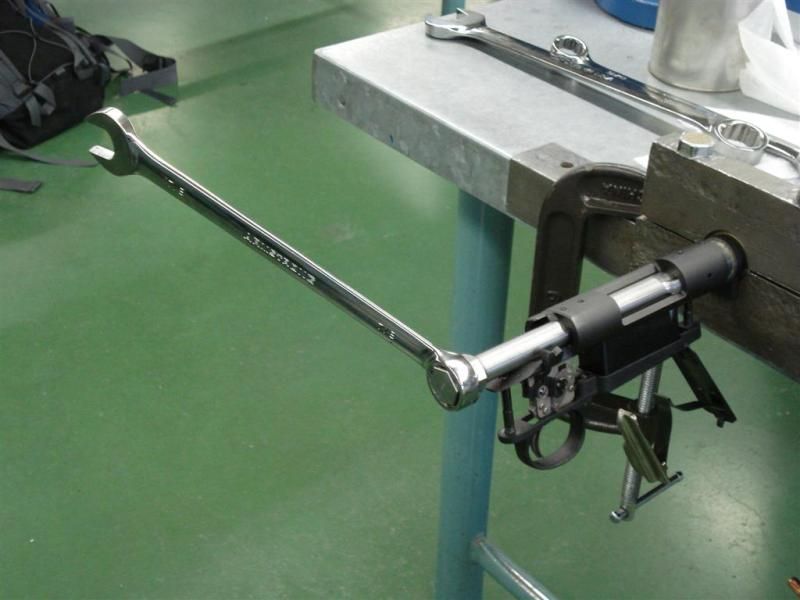

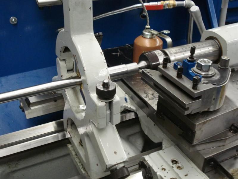

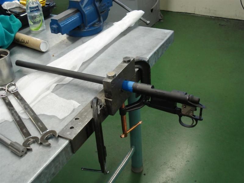

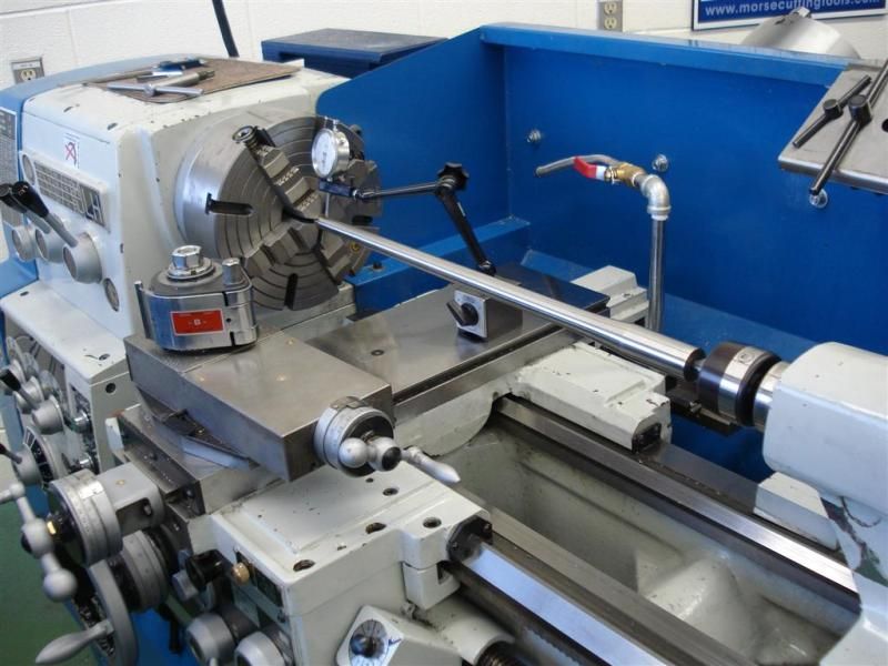

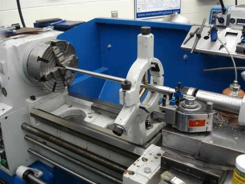

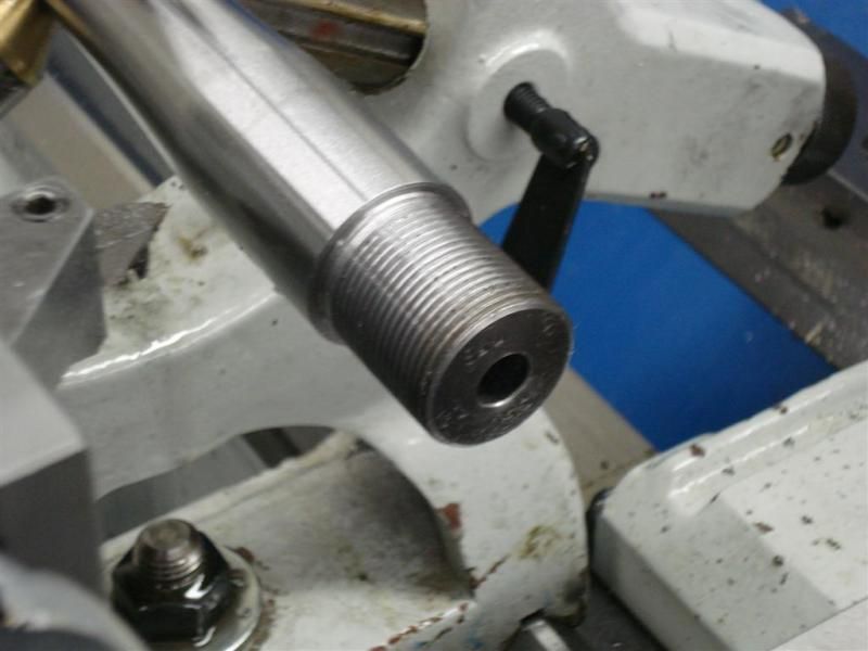

I'v very jelious of the others here who have mills and lathes. I'm hoping to one day pick up a lathe for myself. For the time being, I'm taking machining courses at SAIT and working on my skills. I'm just starting on my second rebarreling project. Here are a few pics from my first rebarreling job.
