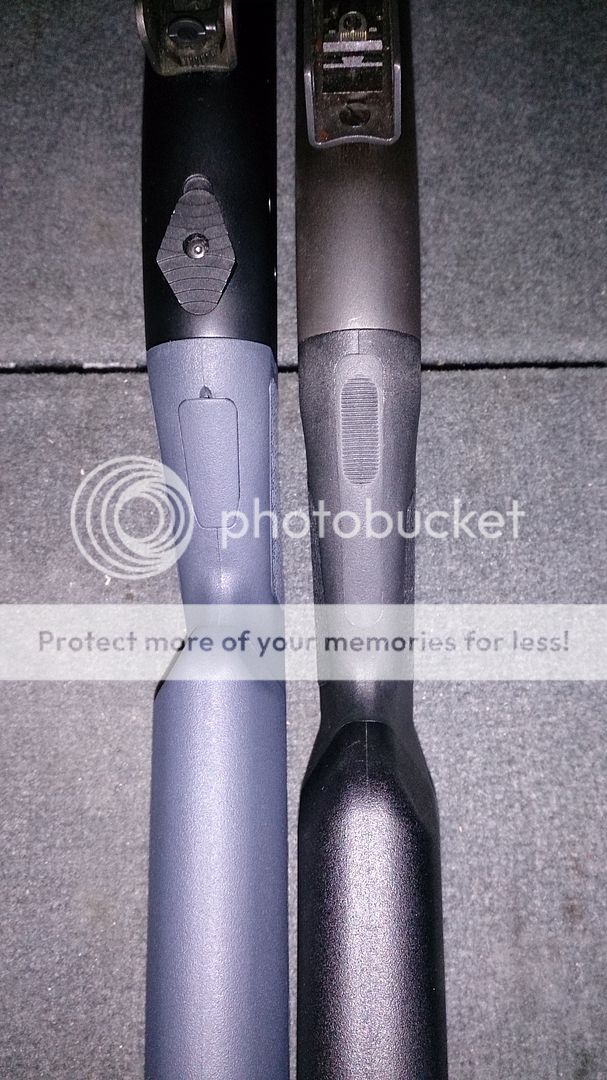

Nice side by side, pretty easy to see that they kept the distance from the grip to the trigger similar on both, and to do that they had to make the Mossberg grip closer to the end of the receiver to account for the space taken up by the area where the action release is on a Mossberg.
They took the time to build the stocks specific instead of trying to adapt something to work with both.
