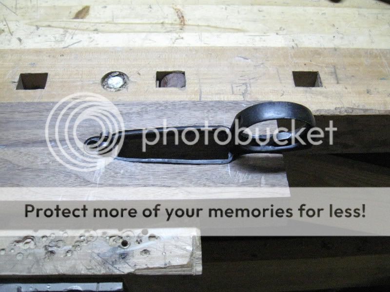

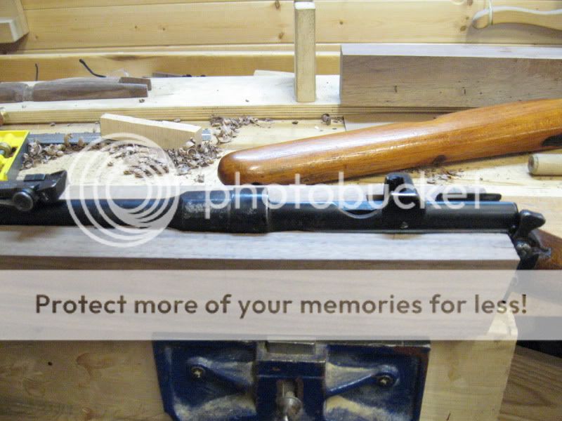

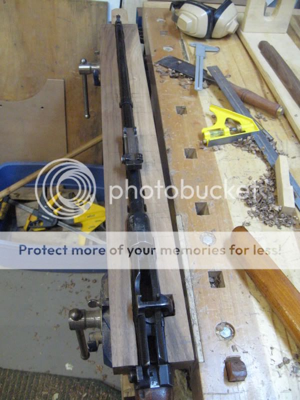

I did a bit more on this project. The action fits into the wood, I only need to lower it a bit at a time, until it is bedded as best as I can.
Some pics of my square rifle !
You know bob, if you left the forend just like that, I bet the recoil felt at the shoulder wouldn't be that bad! :D
Thanks for the progress report, that's pretty impressive work.
Lou
I hope you like to whittle. Some place in that piece of square walnut is a nice fore end.

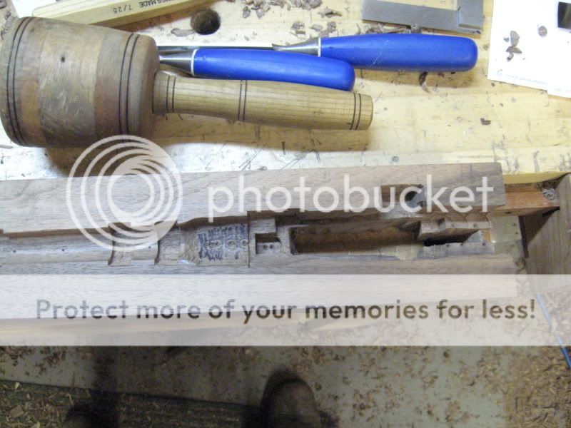

Well, probably not. I can live with some small defect once I'm going to be done with this, but I would feel bad to sell something not 100% perfect. It is all done with the chisel, except some hole with a press drill and fostner bits where I need some sort of precise flat surface.

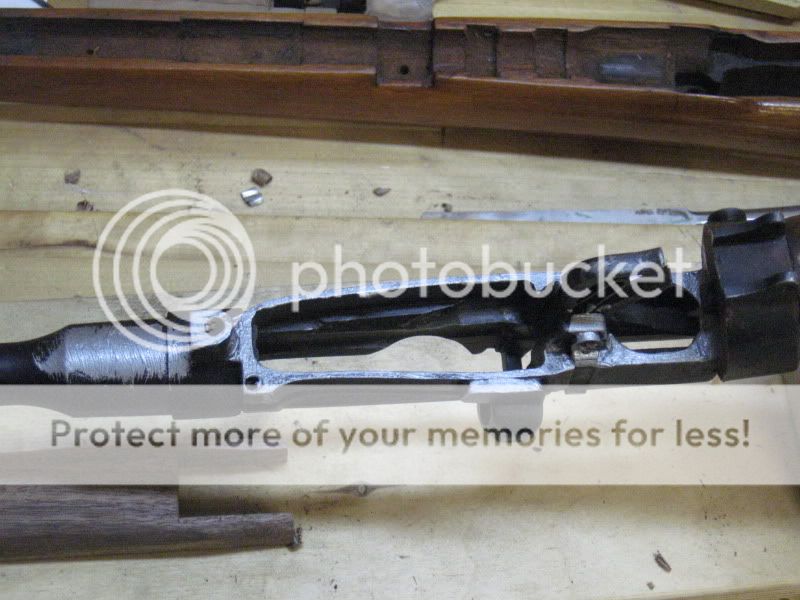

I tought of something to see my progress while I'm trying to bed the action into the wood.....the good old, greasy, messy anti-seize ! I will probably hate myself when I'll wash it, but hey, nothing like a clear grey area to tell you where to remove wood !

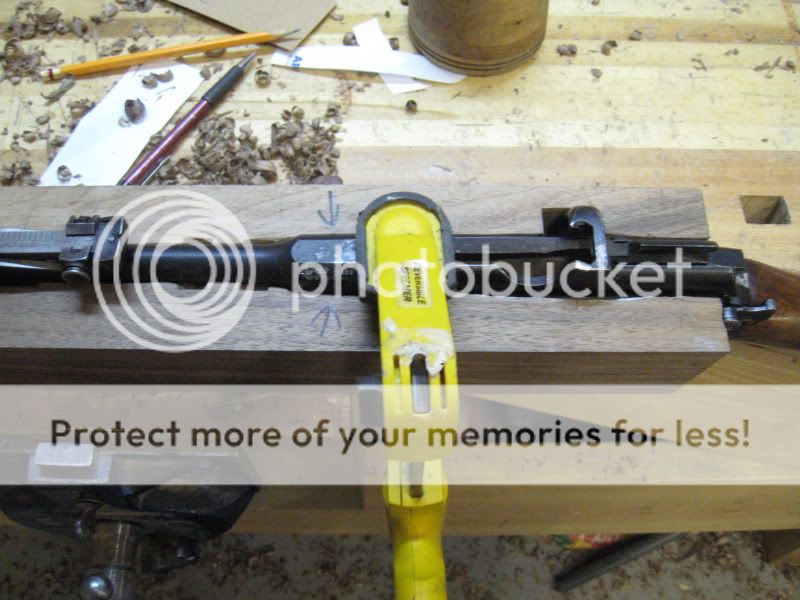

However, I don't seem to find why the action is not going down in the wood. I got a bit of grey, remove it, and I put it back in with a clamp, however some time there is no grey area, and I cannot find why it does not go down...any idea ?
Yup, I got it. On my last pic, I think that the arrows point to the place where the barrel should rest. At least, it rested on my old stock. For now it is not even touching this spot, so I'm lowering around until it does...
Maybe try bedding the suspect area (or rifle part) with a bit of modelling clay, plastiguage style. Works great for tinkering with cars why not inletting a stock?

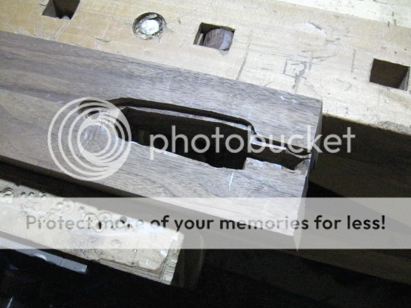

And here is what I've been doing tonight. Still need to level it down a bit, but I'm getting there
