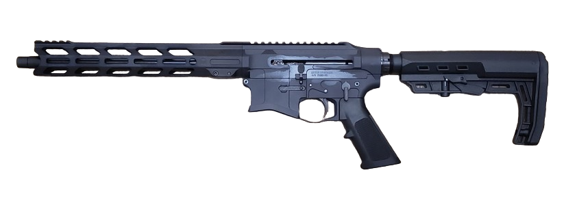

12.5" Renegade fresh off the production line...
