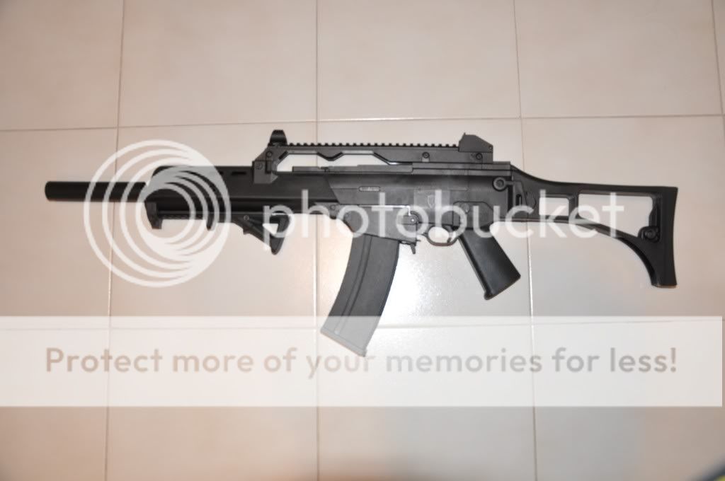

PERFECT! One of the exact setups I wanted to see! The AFG with no Optics and the Suppressor Shroud! Thanks Bigchinny!
U are welcome Major Sights, was playing with the idea of putting in a dlask bull barrel later on...
Hey Dave @ Hical, have u built any with the bull barrels yet? Some pictures of the marauder kits with bull barrels would be much appreciated! :cool:

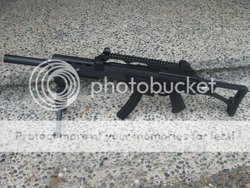

How about this one!!
Dave of hical.ca hooked me up too, great guy to deal with !
I pinned the stock with a countersunk 4mm screw, and went with a dlask 12.5" .750 barrel with a levang linear comp.
They did an outstanding job with this stock, it feels very solid, and it looks and feels just like my hk sl8 which is also in the pics.
I threw an airsoft 3.5x carry handle scope/red dot on there for giggles, but I think I like the vortex sparc better. The real g36/sl8 rails/carry handle scopes mount up perfectly.
A big thanks again to Dave at hical !
