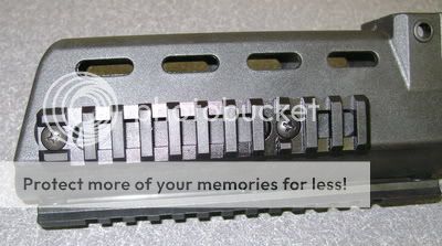

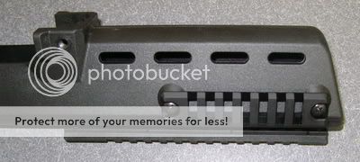

We now have the Dlask Marauder side rails in stock, some sample pics.
Long rails.
short rails.

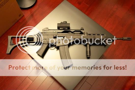

Marauder arrived today
Just got my stock in all courtesy from Mystic Precision... Thanks Jerry!! :D
Arrived at 11am; everything put together by 2:30pm.
She's a beast and looks fantastic!
I had a few minor build hiccups:
1) On mine, the barrel V block was digging into the Marauder stock, so I had to do some minor inletting with a sharp chisel to shave .5mm off the inside on the right side of the stock. Went together slick as snot after that.
2) The top Marauder reciever has four holes that line up with the four holes on top of the 10/22 reciever (normally for the scope rail; and have small plug screws installed). On the Marauder reciever, the two rear holes are not moulded all the way through, so I had to drill them out. Did not matter as the shoulder that the provided screws head would sit on is so high that the screw threads don't extend beyond to screw into the 10/22 reciever. :rolleyes:
The forward holes are fine.
This is definately a design flaw by Promag/Archangel.
Other than that, it was an easy build. Now I just need to get to the range to give her a workout. :ar15:
