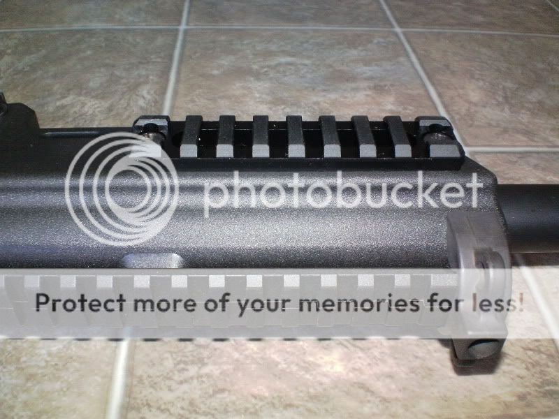

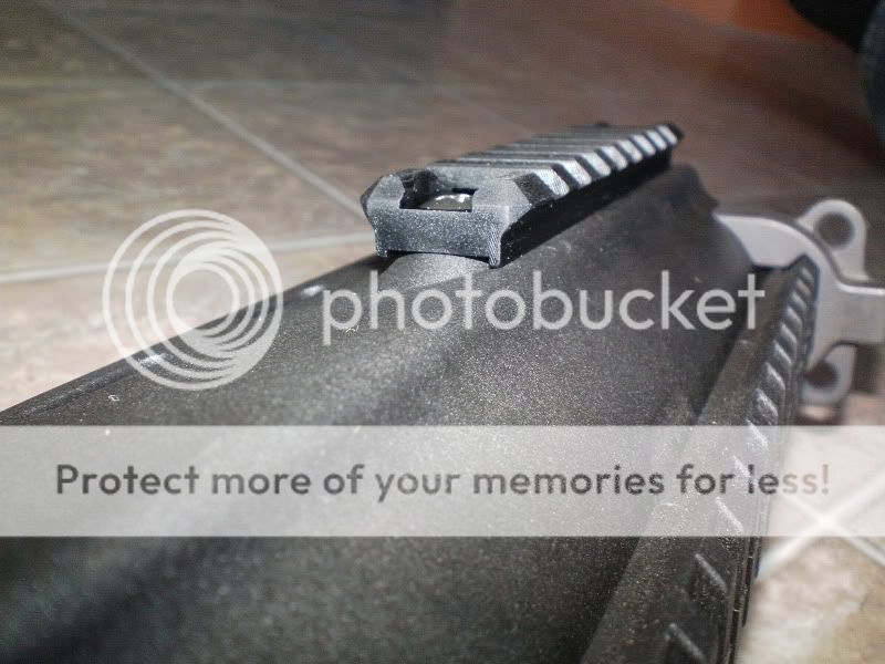

Got the short rails from dlask for the marauder.
They're very light, and have a recess machined into them that allows the plastic mounting "nub" to tuck up inside the rail. The rails sit nice and tight to the handguard.
The other, intended for airsoft, rails I tried didn't have that recess and sat up a bit too high.
Thumbs up to Dlask, thanks for making these available !
