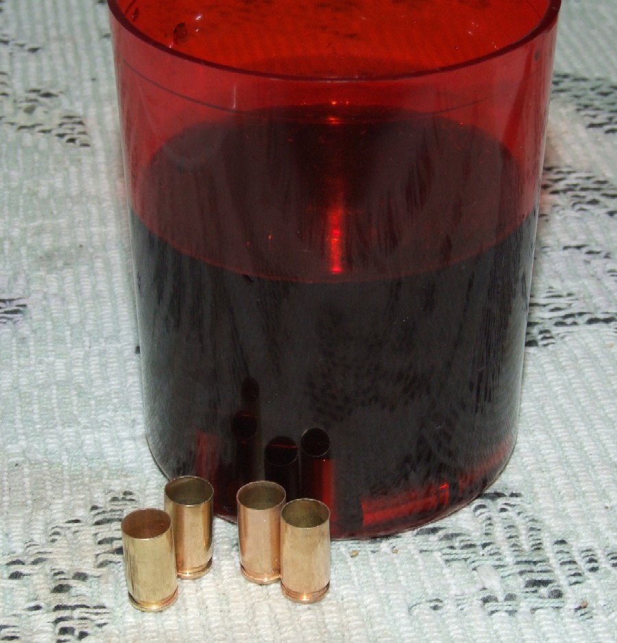

acrashb said:Done (although with regular detergent - we don't have a dishwasher). We'll see what happens by morning. I used Lime-Green.
Why not? said:Okay, looking for your report of success in the morning!
