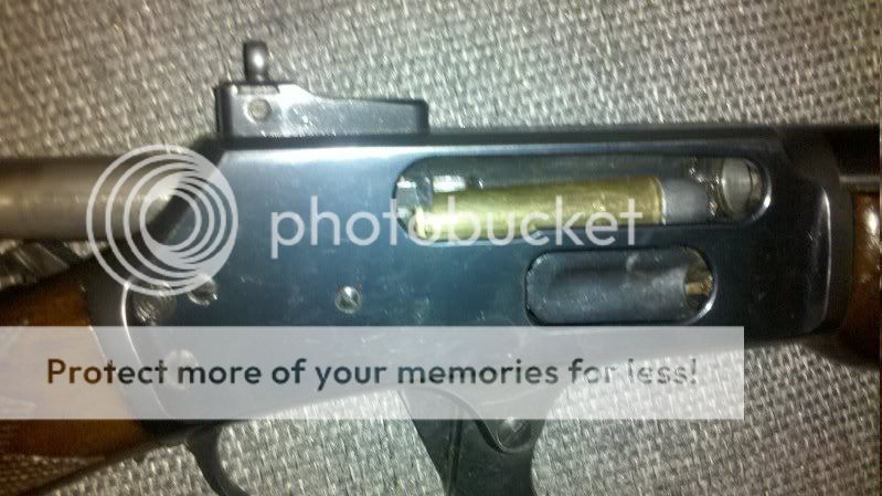

Mine has jammed up solid,1895 in 4570, the round when cycled has the rear end come up and the bolt will not move. If I point it down and jiggle the gun the round falls free,unnerving to say the least if it did it in a critical situation. It has done it a few times now.
The Marlin is on schedule to be delivered today. I called Gravel Agency and talked with the Gunsmithing department. They told me that they replaced the extractor.
this is what it looks like,cannot move lever at all![]()
