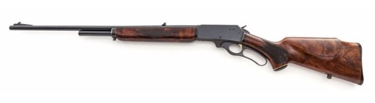

What about a 25-35? I don't think Marlin ever chambered that cartridge.Building a classic Marlin 336, with squared lever, straight deluxe stock and forend. Barrel and cartridge options currently are 35 Rem in a 20" barrel, or 30-30 in 16.5". Mag tube can be full legth, or button.
Which is preferred and why?
Any other options to look at? 32 Win, 38-55?
Octogon or Round?
Thanks!
R.
