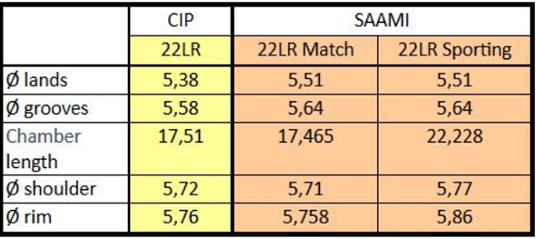

That internet-repeated generalization is often misunderstood. In CIP-member states like Czech Republic, firearms manufacturers such as CZ make firearms to CIP specifications. CZ doesn't have smaller bores than allowed by CIP regulations. Firearms made in places such as Germany and Finland are also made to CIP specs, including Anschutz and Tikka, among others.
North American-manufactured firearms are generally made to SAAMI specs. These include Savage, Remington, Winchester.
CIP specs are different from those of SAAMI. Below is a CZ-produced chart that illustrates the differences between CIP and SAAMI for .22LR. SAAMI .22LR bores are larger than CIP bores.

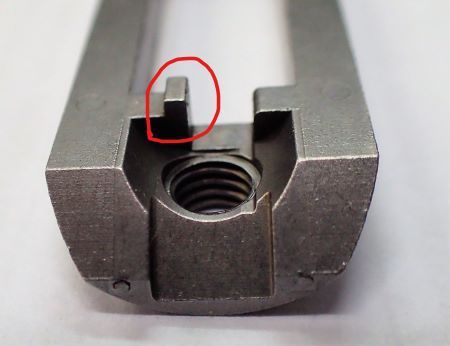

The "CZ match" chamber is no less than 5.72mm (0.2252") at the shoulder, which is as small as permitted by CIP standards. This is not too tight for a .22LR cleaning rod, which will be less than .22" in diameter. The reason why some .22 rods don't work well in many CZ bolt .22LR regardless of model is because the CZ ejector interferes with the rod.
The best solution is to use a .20 cal cleaning rod which will clear the ejector. Pro Shot makes a very good one-piece stainless rod. Nordic Marksman is one site sponsor that carries them.
I use a Pro Shot one piece stainless .20 cal rod, a Pro Shot adaptor and a Possum Hollow bore guide, all from Nordic Marksman. Very happy with this set up.
Alternatively, one might remove the bolt guide plate before cleaning and any standard .22 cleaning rod (except perhaps nylon coated) will work with ejector interference removed from the equation.
