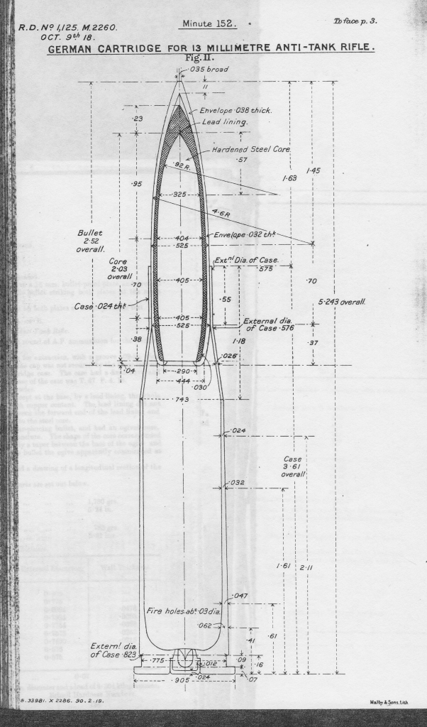

Mauser 1918 anti tank update april 14 and 15 finally have pics!
Not sure, I believe it is a 1905 or 1906 Mauser Selfloader.

The 13mm. Mauser "Tank Abwehr Gewehr",as it was called by it's originators, was the
first antitank rifle ever designed and was an overgrown sporting rifle measuring 67" long
and weighing 35.8 lbs. The beasty also sported a pistol grip.
This rifle was a single shot, 90 degree bolt lift design and the barrel band around the fore stock
accepted an MG 08/15 bipod. The 13mm cartridge propelled an 800 gr. bullet at over 2700 fps.
which put it slightly ahead of the .50 BMG in terms of energy. The 13mm could pierce 1" of armor
at 250 yds. It was introduced in 1918 and Mauser also developed a box magazine version that
never got into action before the signing of the Armistice. Too bad, because this uber rare AT
rifle would be a great collector piece.:)

Well,
Based on the detail above, I believe I have a single cartridge case + bullet from a Mauser 1918 AT Rifle.
