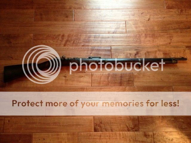

I have a full wood, all matching intact 1886 Danzig made 71/84, and I love it!!
Just waiting on the mail for my Reloading dies, bullets, and brass for the .43Mauser (11x60mm)! Beware, the Brass can be EXPENSIVE!!!! I think it was $72.50 for each box of 20 pieces of .43Mauser Australian made Bertram Brass... :eek:
My rifle is marked to the same regiment as yours too! :D
50.R.7.207
I looked up the history about it awhile back and found the same info as you. Very cool, as some of my ancestors lived in Ostpreußen wayyy back in ze day! ;)
Would really like to find out where my rifle served, and whom it served under! :)

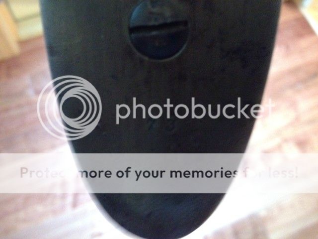

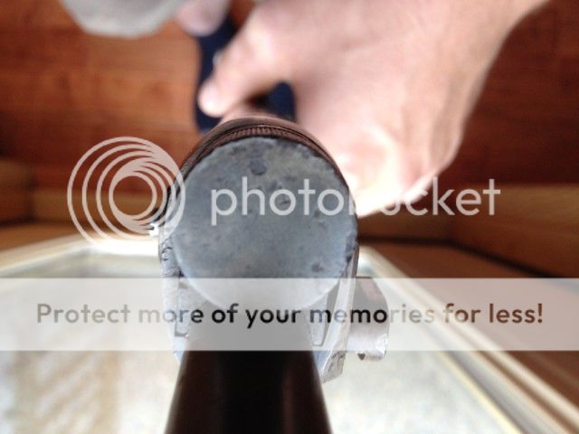

I thought it was all matching, but a piece on the bolt is marked "71" instead of "73", and also the magazine tube end cap is marked "71" as well, and it doesn't have the stacking swivel??? It doesn't look like it broke off or anything... any ideas?
PS: Does anyone know why photobucket is flipping all my pictures upside down??? :mad: I had them all in order and right side up, and photobucket does this to me!!! argghh! (EDIT: Well, 45min later, and it looks like the pictures are now finally right side up and in the correct order... ughhh...)
Considering the stacking cap is not matched to the receiver, it is possible the original one was damaged and this one was swapped on. I can't tell you if it had the stacking rod before or after this change but given the other parts that match this number, it was likely swapped by an armourer in the field as a regimental armourer would have lined out the old numbers and re-matched the parts during pre war and early war service.
