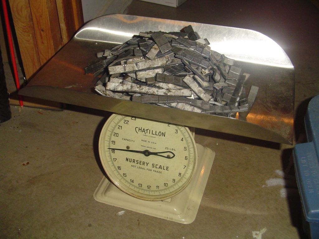

It seems the quality and suitability of wheel weights for casting has gone down since this article was first written. I picked up a small bucket the other day ( maybe 25 lbs) and a lot of steel and zinc- the stick on weights were mostly steel. I pulled only 7 ounces of lead stick on weights out, and have yet to sort through more thoroughly. Somebody should post pics of what types are zinc or steel for a quick visual reference.
I preheat my weights on a frying pan before smelting them and the tape comes off easy once they heat up. I preheat weights for two reasons, speeds up process quite a bit and I wash my weights before sorting so need to make SURE they are dry before going in smelting pot.
Another trip to the same tire shop and got just over 5 lbs of the stick ons in a quarter bucket of weights. A lot seemed to be newish and unused. Double sided tape not even peeled off. Seems like this will be my go-to shop, since I want the soft lead for the black powder Minies. Anybody in Nova Scotia who wants a couple buckets of clip on weights, let me know. I probably won't be using them anytime soon.
