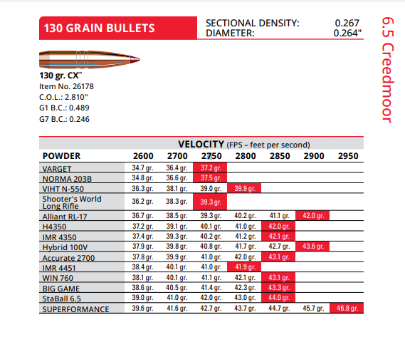

It looks (for now) like its going to be a Tikka T3x with 24.3" barrel, 6.5 Creedmoor, 130gr Hornady CX, H100v, trying for as close to 2900 FPS as I can get. Manual says its doable, but guns be their own individual beasties, as we all know.

Dangle that 130 as long as possible, and the 2900 should be easily achieved. What powder? Drop numbers looks good as well.

Hybrid 100v will be the fuel I try. Its available and at this moment, cheap. Would try RL17 but its powdered unicorn horn right now lol
If Federal's 130gr Terminal Ascent was still available as a component, really wonder how fast that could be pushed with safe handloading. Had an even better BC.
There will powder crushing at 44 grains with the 100V... Not sure what your tolerance is for seating as long as possible. Lever may be a better option, and it seems to be available.
