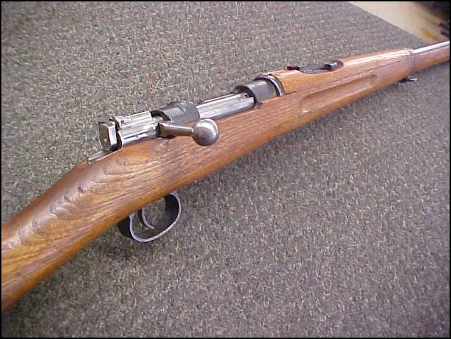

Read the disc on the side of the rifle, what does it say about the condition of the bore?
It would be worth seeing with a walnut stock, I've only seen beech-stocked m/96 rifles.
My own 1898 m/96 - serial 896 - has a beech stock, BTW.
Does it have a threaded muzzle? If not, then it's likely never to have been in military service, but in the Swedish civilian marksmanship programme.
tac
The stock on that rifle is stained Beech.
I have quite literally seen thousands of the Swedes. None of the rifles I have seen have been unfired since leaving the factory as new.
The Swedes were very careful to maintain their rifles properly. Mind you some of the later releases were pretty grungy and worn.
The M94/96/38 rifles were mostly re barreled several times and FTRed to as new condition regularly during their service lives. The rifle you have in your pic is such a rifle IMHO.
Still, it is a lovely piece and even if the $500 mark is a bit high, IMHO it is worth it. If you don't beat it to hell when you take it to the range, it will appreciate well beyond that figure.
One other way to tell if it is original is if the cleaning rod is serial numbered to the receiver. Rifles with matching cleaning rods are very few and far between in my experience. I have seen collectors pay a very decent premium for matching numbered rods.
The matching rod would not indicate the rifle hasn't gone through and FTR, just that the REME was being very careful.
