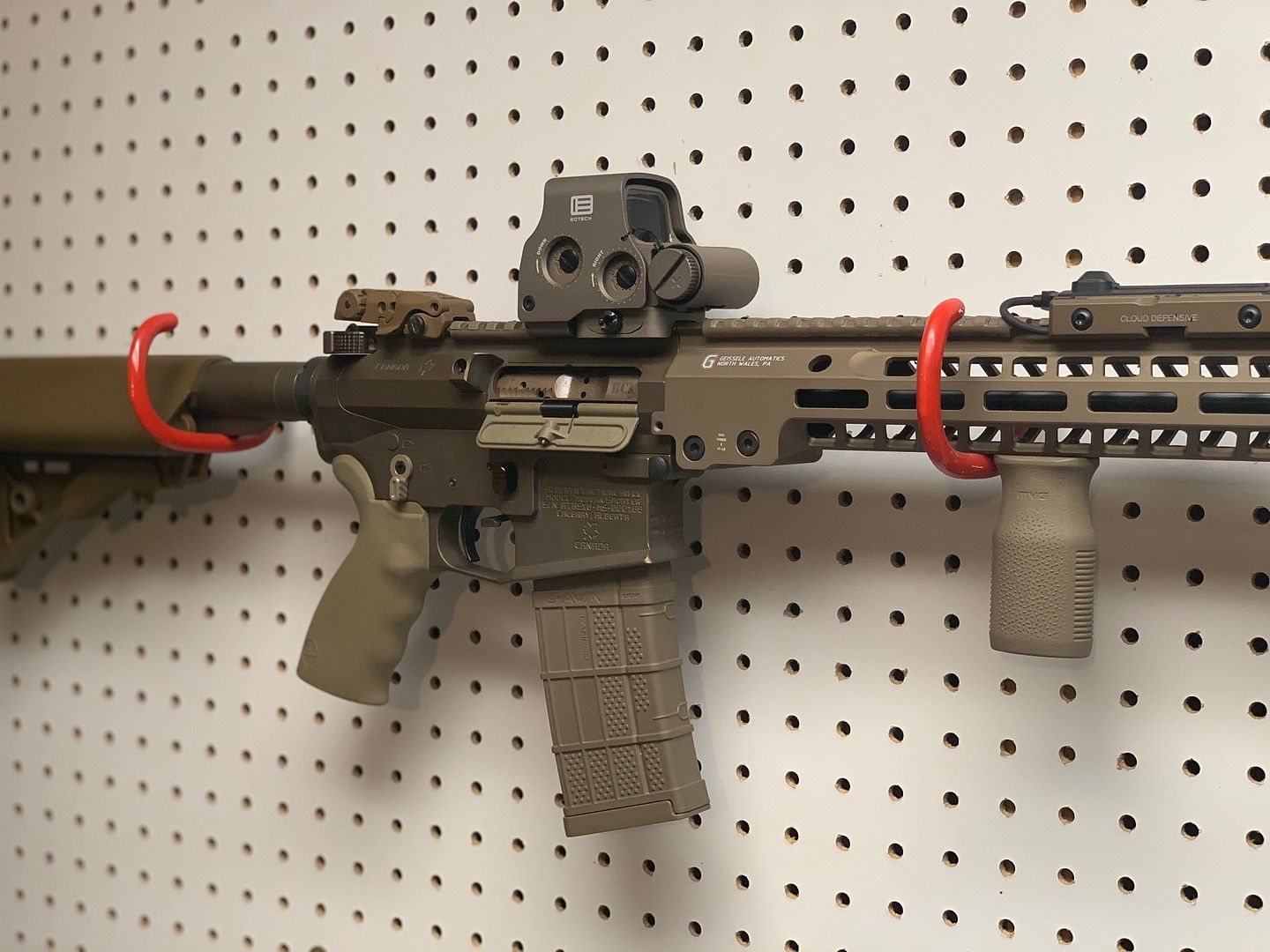

Actually here's what happened to one of mine.
Gen 3 Pmags are known to cause bolt catches to "slip", sometimes partially due to the bolt catch moving rearwards if you insert an empty mag(I know, why insert an empty mag?). Nonetheless what I did was I took a C clip off of a ejection port door pivot/strut, clamped it a little tighter so it'll fit perfectly on the roll pin of the mag catch. I think a washer works too but they don’t usually come in black. Problem of slippage disappeared after.

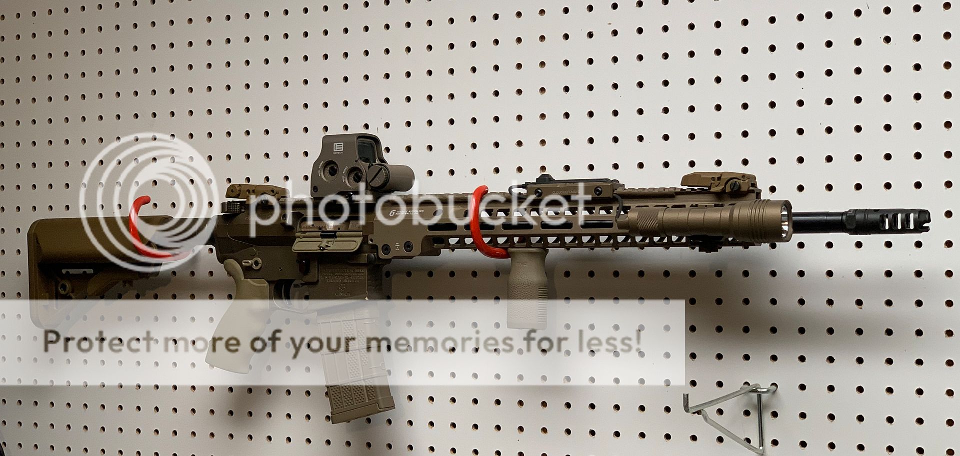

Nice build!
I've also been waiting for a NR barrel in 458 socom... think MRA was planning on spinning some up...
Last I heard they’re waiting for a bit because of a change in location or something like that. I could be wrong. McGowen can make the barrels and possibly IBI as well.
