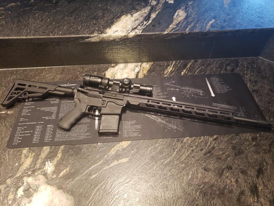

Received my build from ATRS a week ago and am 100% satisfied with how it turned out. Shoots like a champ, weighed in at 5.8 lbs without optics, and very well balanced. The TT trigger is awesome!!!
A big shout out to Dustin who assisted in spec'ing the rifle.
ATRS Modern Sporter upper/lower receivers
Trigger Tech adaptable flat trigger
Ergo Suregrip
ATI Stock
Strike Industries Charging Handle w/ extended latch
18.6" Faxton gov. profile barrel *** In Canada, our barrels on a semi need to be 18.6" or longer or the gun needs to be registered
15" MRA V1 MLOK handguard
ATRS Flash Hider
Vortex Strike Eagle 1-8 LPVO
When did you place your order?

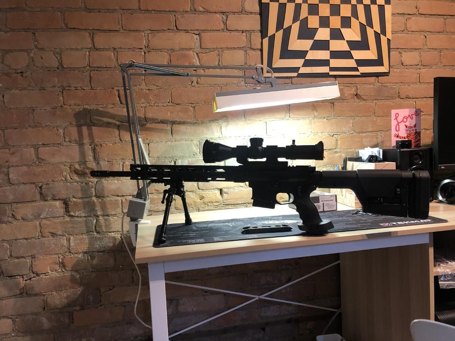

Just completed my DMR build, getting less than half a minute with handloads. Very satisfied.

Beauty
Any other Lightweight parts besides the barrel and stock?
The 15" MRA V1 MLOK handguard is the only other "light weight" item coming in at 10 oz. This rifle is meant to be a 'do it all' and I decided to stay away from a lightweight BCG and adjustable gas block or else I could have dropped the weight a bit more.
