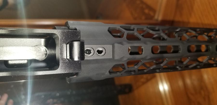

So I don't have the barrel installed yet, as I am waiting on another for this upper but it looks like the Odin O2 lite handguard is good to go as far as the anti rotation tabs. Looks like they just clear the sides of the upper with the rail lined up.
I will update once I get the barrel.

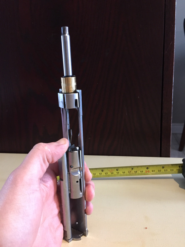

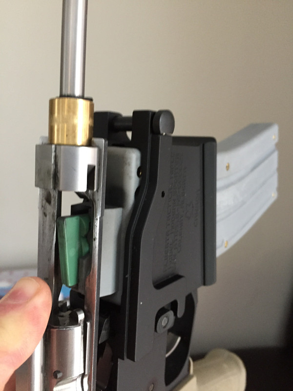

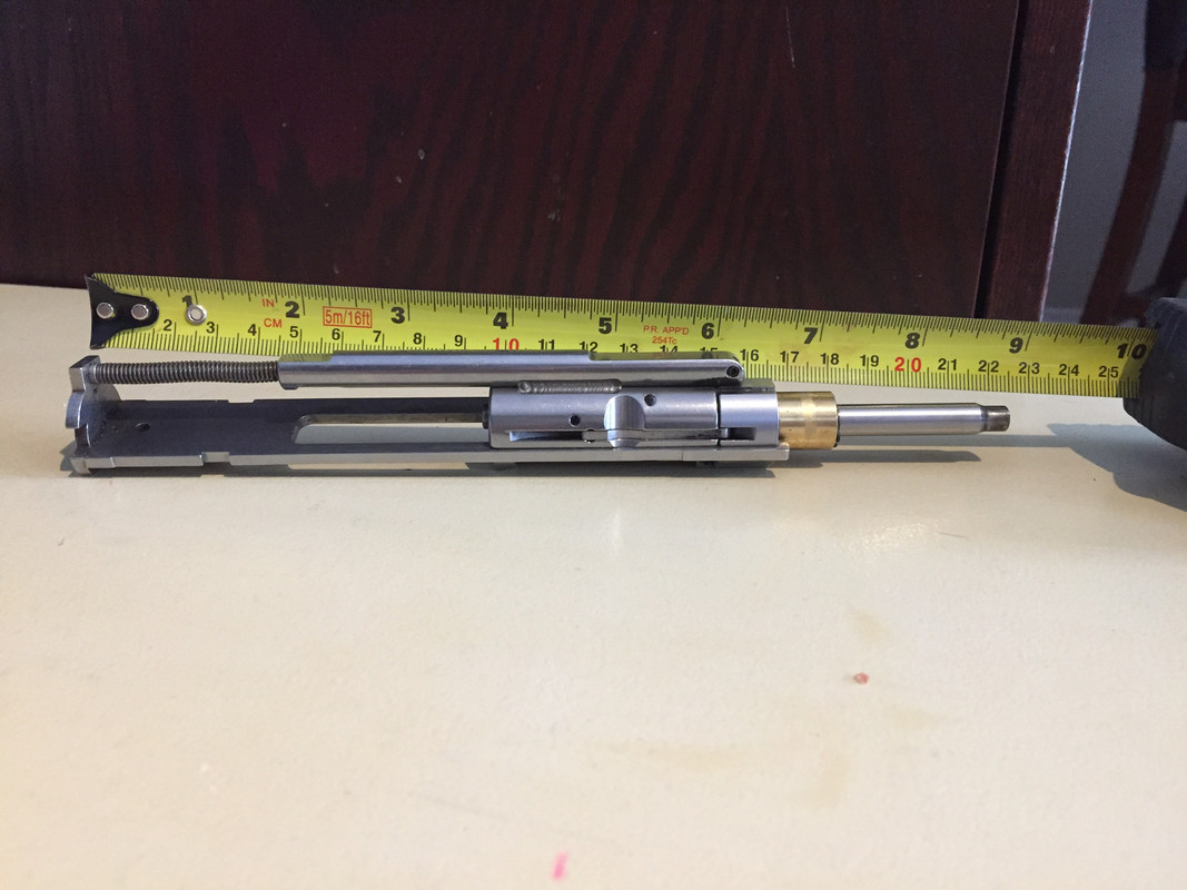

So back to the modification of the cmmg kit to fit the sporter. I took some pics to get ideas. My upper is still in Canada post land. But looks like the lower main support bar if shortened a little bit will work as there’s lots of room when the bcg moves backward to re chamber a new round.

Looks like you could shorten and re weld the lower main support....Depends on if the spring will coil bind on open bolt......looks like you might have to shorten the spring... and spring guide and tube as much as the support bar.....

Either that or cut off the tab and on the back and tack on peice of angle to move where it’s attaches to spring forward . Having just the circle in back should let it go into buffer tube .
Yeh doing that the bolt will not open fully so the spring and tube that captures the spring that attache's to the bolt would have to be shorted too.... looking at photos. Its hard to tell when its not in your hands.
Looking at it now i see what you mean . Either way it’s done the spring and guid rod will need to be shortened. I’m glad this thread exists. Looks like the 2a kit will be the one I choose . Then into the chop saw and hack .175 off the back. Anyone know where to get the 2a kit already tried the google
