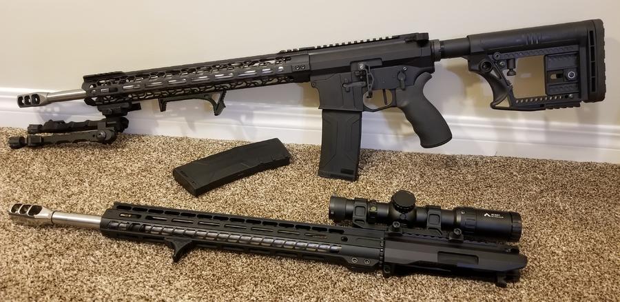

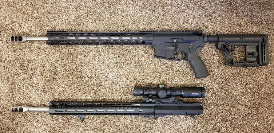

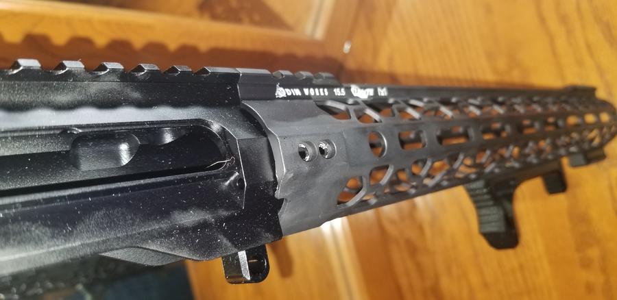

For those curious about G96.
Once I applied it to my upper it matched perfect to my lower that was oiled by ATRS.
My Odin O2 lite handguard was quite dull compared to my reciever set so I gave it a soak as well and now it matches the MS perfectly.
Before
After
Before
After
THANK YOU SO MUCH FOR SHARING. I’ve been batting around the idea of Cerakoting my upper/lower and handguard to have the set match... this confirms oiling it gets things close enough that I won’t lose any sleep over it lol.
How often does one need to oil things to keep them matching?
I recieved my lower oiled with G96 from ATRS, I applied G96 to my upper then to my handguard.
Just one thorough application with G96 Gun Treatment, I let it sit for 10+ minutes as per directions then wiped off. It soaks in and looks more uniform after a couple of days.
I'll be doing my Odin O2 Lite 308 handguard for my Stag as well so it matches better.
ATRS says 7075 aluminum and Odin says they use 6061 but I am very happy with the color afterwards. Other products may vary as per what ATRS has said regarding this earlier, different anodizing dyes etc.
