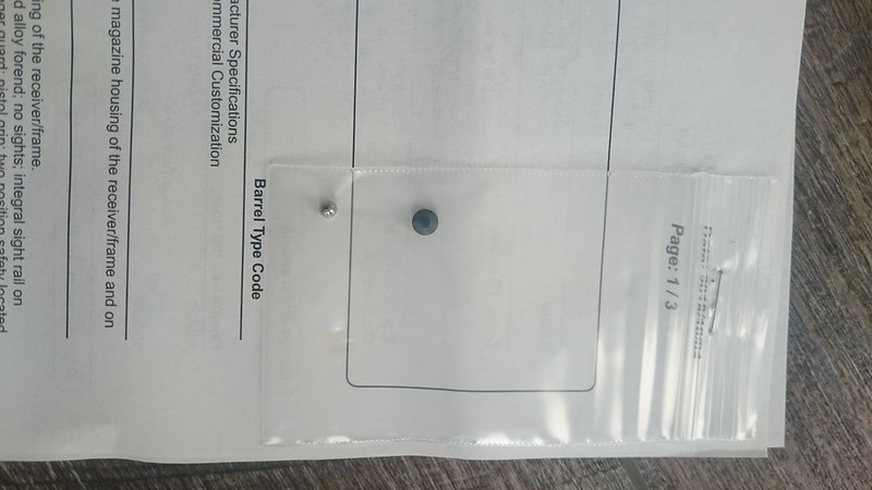

Just a simple question. I've assembled many AR's but have never come across the little threaded cap and ball bearing stapled to the FRT that came with my reciever set...any idea what its for? (I've gone through a few pages of this forum but haven't found an answer) Thanks in advance for any help!
DSC_0680 by https://www.flickr.com/photos/138396073@N05/, on Flickr
It’s the new safety detent. You may be able to use the hole in your grip but they missed by a tiny bit and some grips won’t work sot they came up with a briliant solution. Just cut the safety detent spring down, use the ball bearing not the regular detent then you can adjust the tension on you safety.
Precisely!! Cut the safety spring down to .250"
