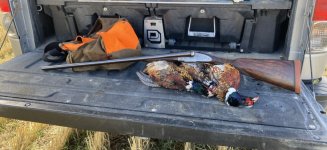

Years ago (20+) I hunted a lot with 3 friends. Mostly grouse and woodcock over dogs. Each of us had 20 ga Ithaca/SKB's SxS. All of us loved them. Mine had 28 in barrels and chocked M&F. The other 3 were 25 in ImpC/Mod.. Mod 100's if I remember correctly. They occasionally still come up for sale. A couple years ago Switzers Auction sold one. No idea of value now. Paid $500 for mine in mid '90's.
This little back actioned 16x16/ 9.3x72R drilling has worked very well super with lighter hand loads on every upland bird I have ever hunted with it from ruffies to pheasants as well as Sharptails!.
It was under $1,000.
Cat
