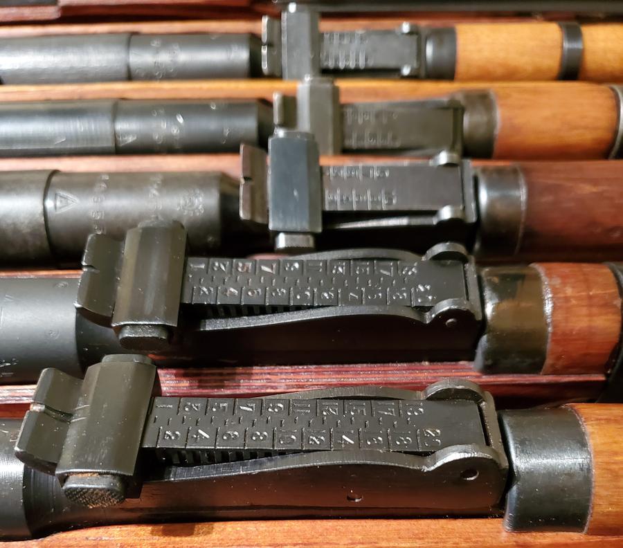

The M-44 rear sight leaf is shorter than a 91/30.
91/30 in foreground. M-44 and M-38 in rear.
