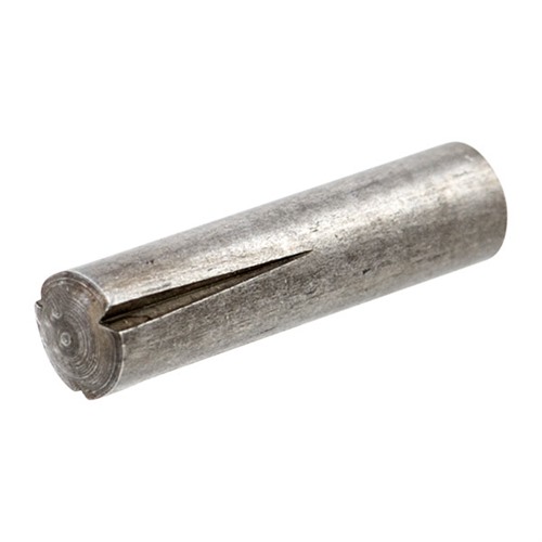

Is it this pin?
ht tp://www.brownells.com/shotgun-parts/receiver-action-parts/receiver-action-hardware/pins/mainspring-retaining-pin-prod9337.aspx?avs|Manufacturer_1=MOSSBERG
Edit: Humm, never mind, found out you're looking for a front shell stop pin it mainspring retaining pin. Maybe you can order one directly from Mossberg?
