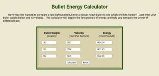

I came across some warm loads from an older Barnes source. Thought I'd share. Touching nearly 2800 fps with 180's, 2600 with 200's, and almost 2500 fps with 220's is getting up there.
