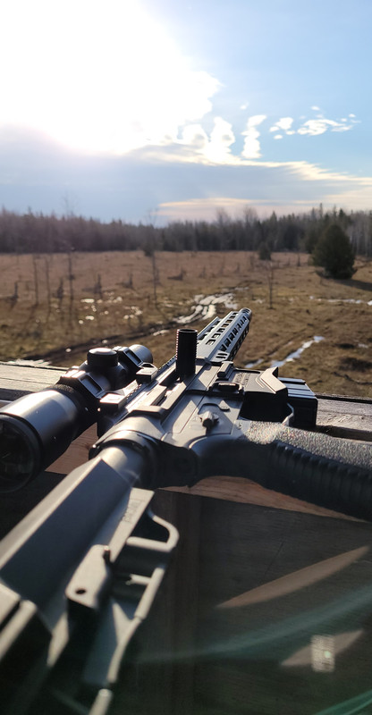

Finally a decent day for the 6.5 Grendel which was fed Hornady 100gr and 110gr's. I had acceptable 100M groups with the 110s pushed with H335 but think I will attempt 120 or 130s next with H322.
