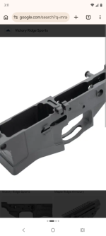

See how there is a shallow trough the bolt catch sits in. This is a 2.0 in the photo. From the outside of an assembled renegade you can't tell.
2.1 has a a fence front and rear of the trough which supports the actual bolt catch (not the ping pong paddle) so it doesn't put all the load on the little pivot screw.
Ok I think I understand now. Thank you. So the pic below is a 2.1 then...
