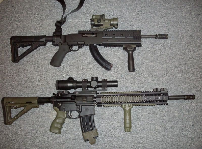

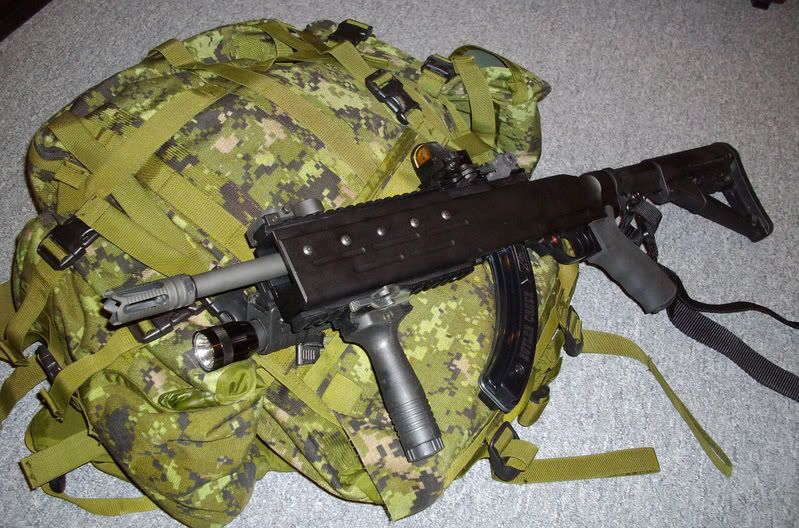

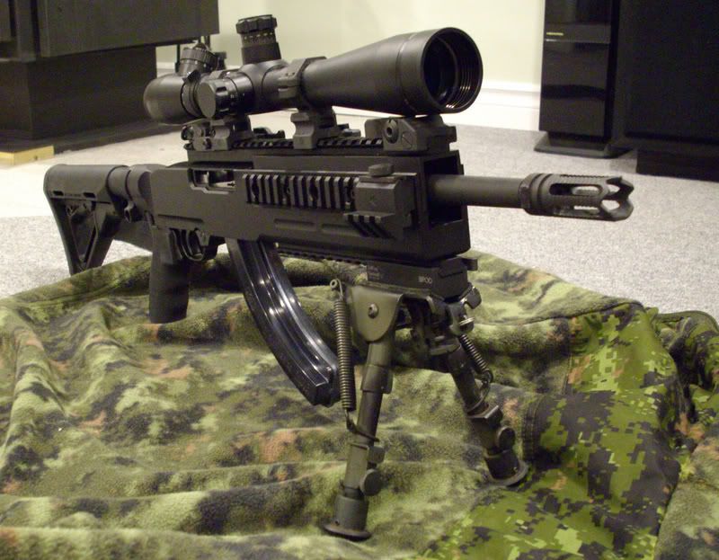

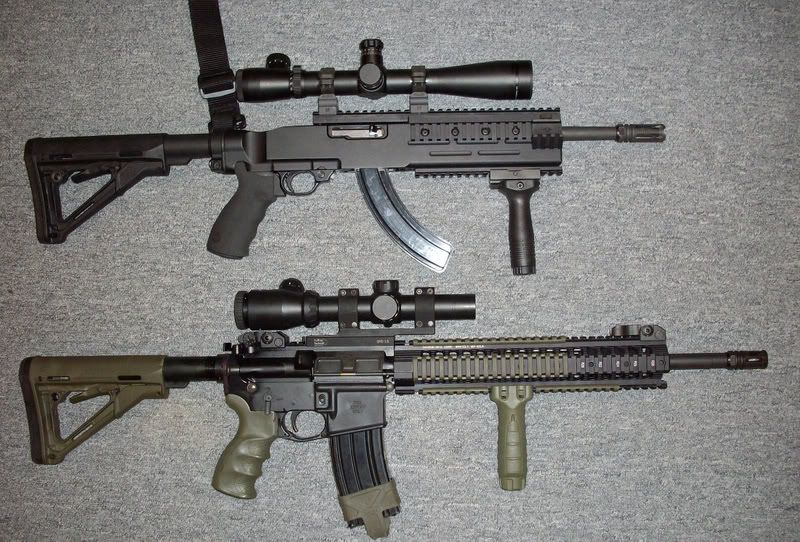

OK, here it is: My TACTICAL 10/22 rig. Like I said in a previous post; watch out zombie gophers and undead squirrels ! This gun's gonna get ya
Seriously, the goal of this setup is be a cheap ammo & non-restr. alternative to my AR15.
- started as an out-of-the-box, virgin Ruger 10/22 compact (this is my first 10/22
). I chose the compact model for the resale value of the 16" barrel, but I'm currently thinking of keeping it.
- RB Evolution stock, with extra scout rail and 7" side-rail (fabsports.ca)
- 11.5" E.R. Shaw barrel, threaded (tacshot.ca)
- YHM Phantom 5C2 flash-hider, YHM angled 3-slot rail, Streamlight Scorpion & First Samco FAS-3 mount (Brightflashlights.com)
- BC steel lip mags (damn.. so many stoppages; around 1 out of 8 rds fails to feed... is there any mods/lubing/whatever, before going to Tac Innov mags ?)
- Magpul CTR stock
- Midwest Ind. QD sling swivel mount (Brownells)
- Home-made single point sling.
- Ergo ambi sure-grip (Brownells); top part was cut for fitting in the Evo stock.
- Tuffer buffer (tacshot.ca)
- Rock Mount 6-9" bipod in Larue mount (Socom supplies), alternating with a front vertical grip in ARMS #17 DR clone.
- Various sights pictured: Troy flip-up front battle sight, ARMS #40L rear sight, Docter optic clone in ARMS #17 DR clone, Leupold Mk4 3.5-10x40mm M1 clone, or Aimpoint clone (last 4 items by 1337tactical), in true ARMS #22 high rings & #22M68.

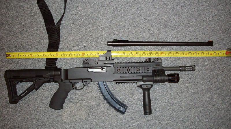

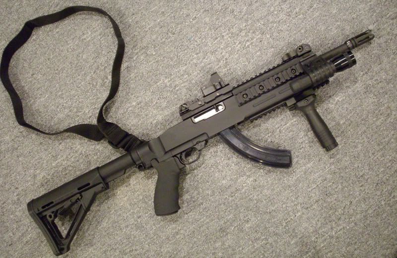

Started like this:

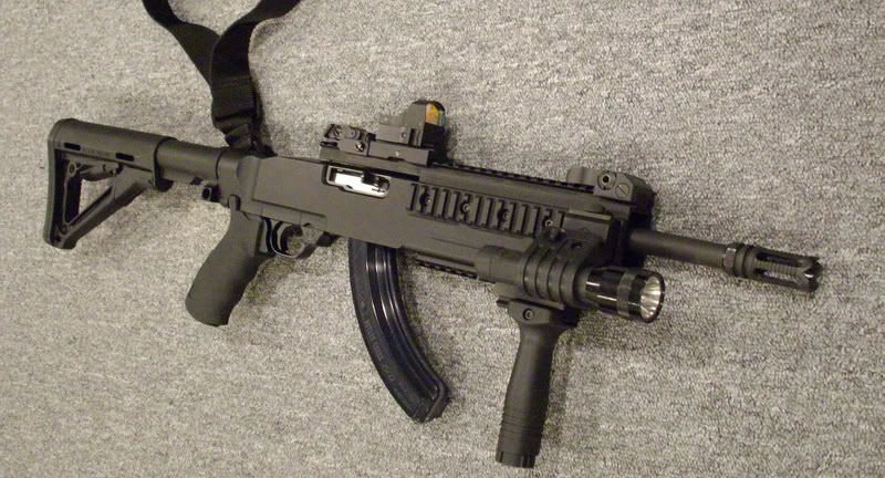

Now looks like this:
Here's the original unfired 16 1/8" ruger compact barrel

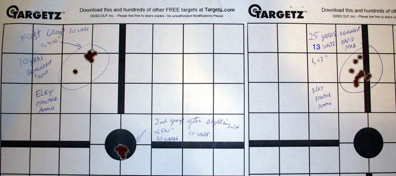

And now for the range report : LOVE IT !! Very nice accuracy
solid build, great ergonomics.
See pic below. Keep in mind the following:
- these were the very first rounds in that receiver and barrel
- all internal parts are factory stock
- crappy ammo (Eley practice)
- Stoppages from the BC SL mags, thus changes in firing position.
- last group at 25yards shot after the "last call" at the range. so it was shot very quickly.
