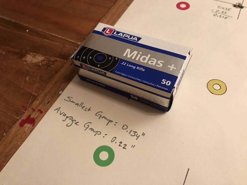

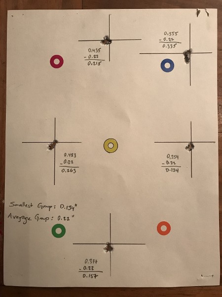

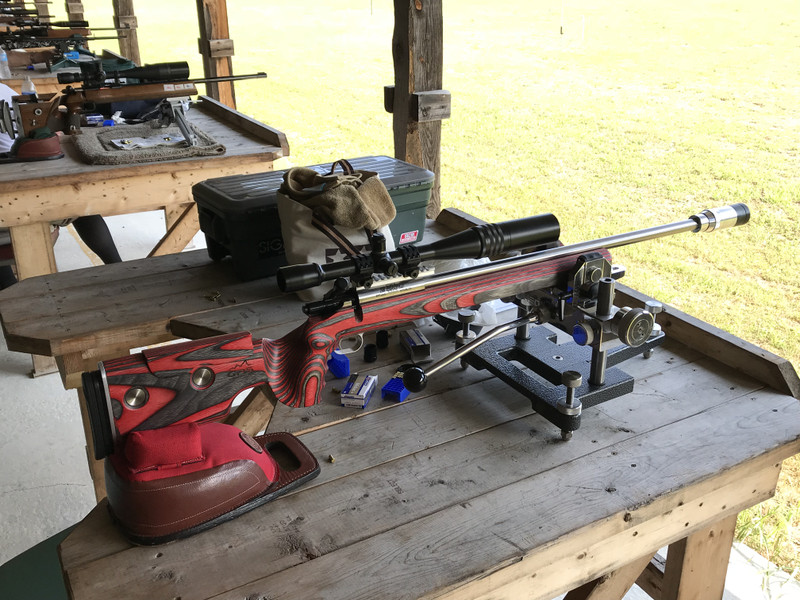

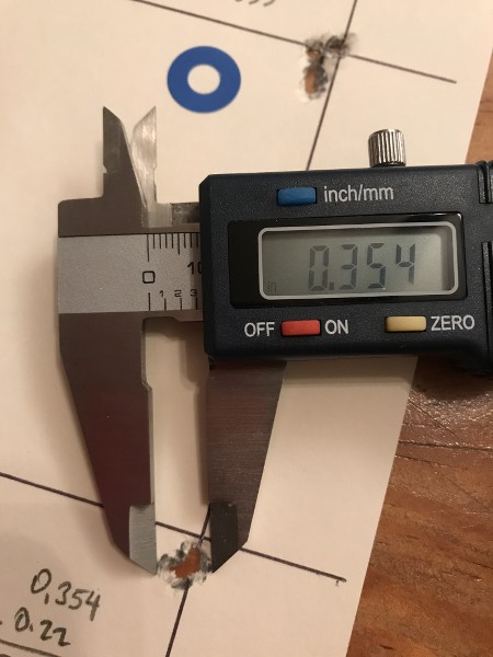

• Benchmark Straight Contour, 3 Grooves, 1-16.5 twist barrel
• Stiller 2500X action
• GRS Hybrid stock
• Jewel Trigger
• Harrell Rimfire Barrel Tuner
• SEB Neo front rest
• Ammunition Lapua Midas+
Smallest Group: 0.134”
Average Group: 0.220”
Some bonus footage of fun shooting from today...
Congratulations. Those are excellent results, gonzales34. That is a great looking custom rifle and an excellent front rest and rear bag. The rifle and the shooter certainly work very well together. It's surprising this rifle hasn't sold since it was posted on the EE. I'd be thinking about keeping it as this thread doesn't see many rifles that shoot as well.
