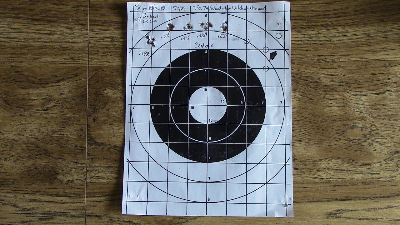

Finally managed to meet this challenge using my CZ455, although the only part left from my original rifle is the action![]()
Rifle as currently configured:CZ 455 action with approx 5000 rounds through it
IBI 22" stainless barrel with Eley EPS chamber (Thank you Ryan!)
Fly trigger set to 4oz pull
MDT LSS chassis (with trigger pocket milled out to accept Fly trigger, action is epoxy bedded to chassis)
Single shot feeder
Aluminum stock machined to track rear bag and 3" wide aluminum plate to track front bag
10-50*60 Sightron III scope mounted on 25moa DIP rail
Range: Edmonton CHAS - ranged at 56 yards

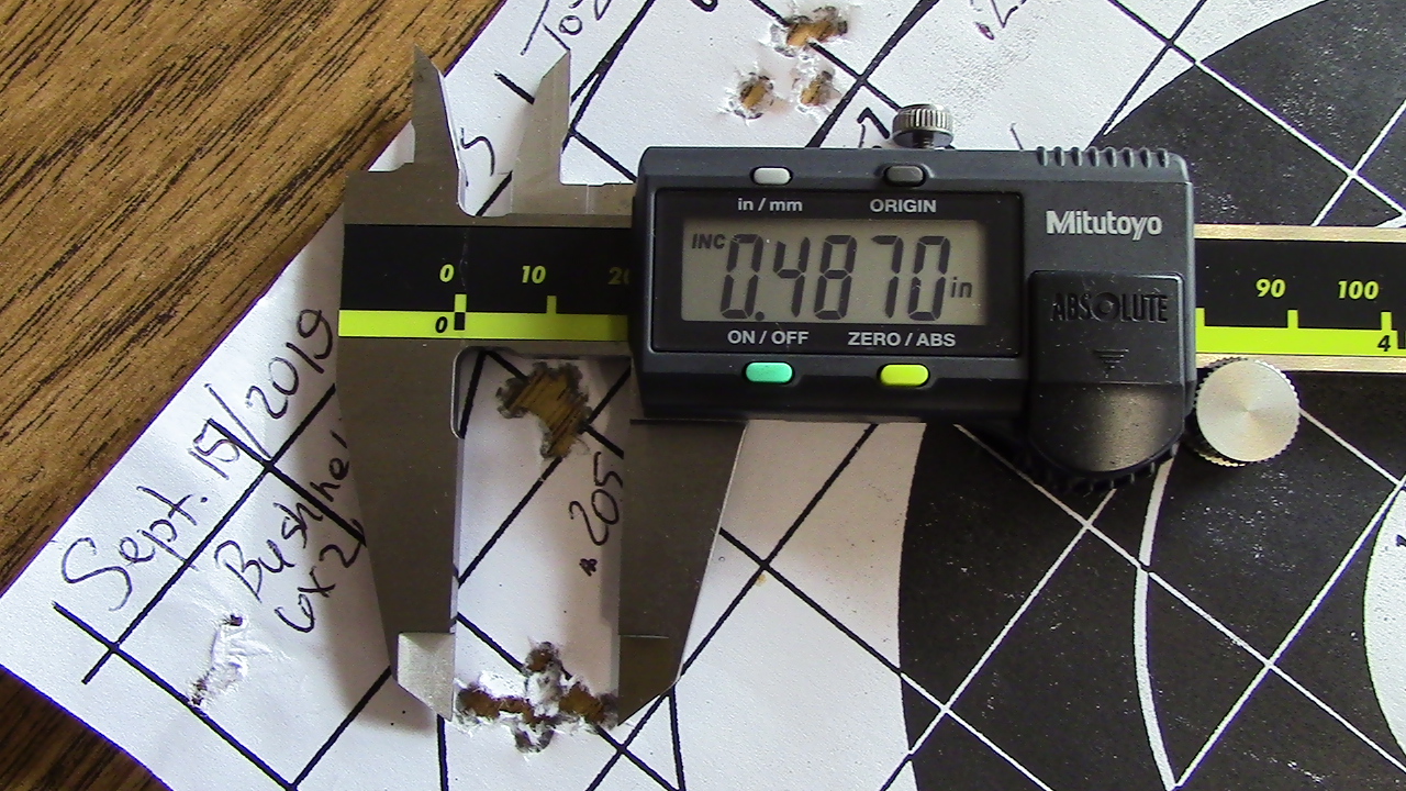

Groups (CTC) with Lapua Midas+0.317"
0.464"
0.218"
0.374"
0.223"
Avg: 0.319"
SD: 0.104"
Groups (CTC) with Eley Tenex0.378"
0.368"
0.458"
0.298"
0.325"
Avg: 0.365"
SD: 0.061"
[/URL][/IMG]![]()
[/URL][/IMG]![]()
[/URL][/IMG]![]()
[/URL][/IMG]![]()
[/URL][/IMG]![]()
[/URL][/IMG]![]()
