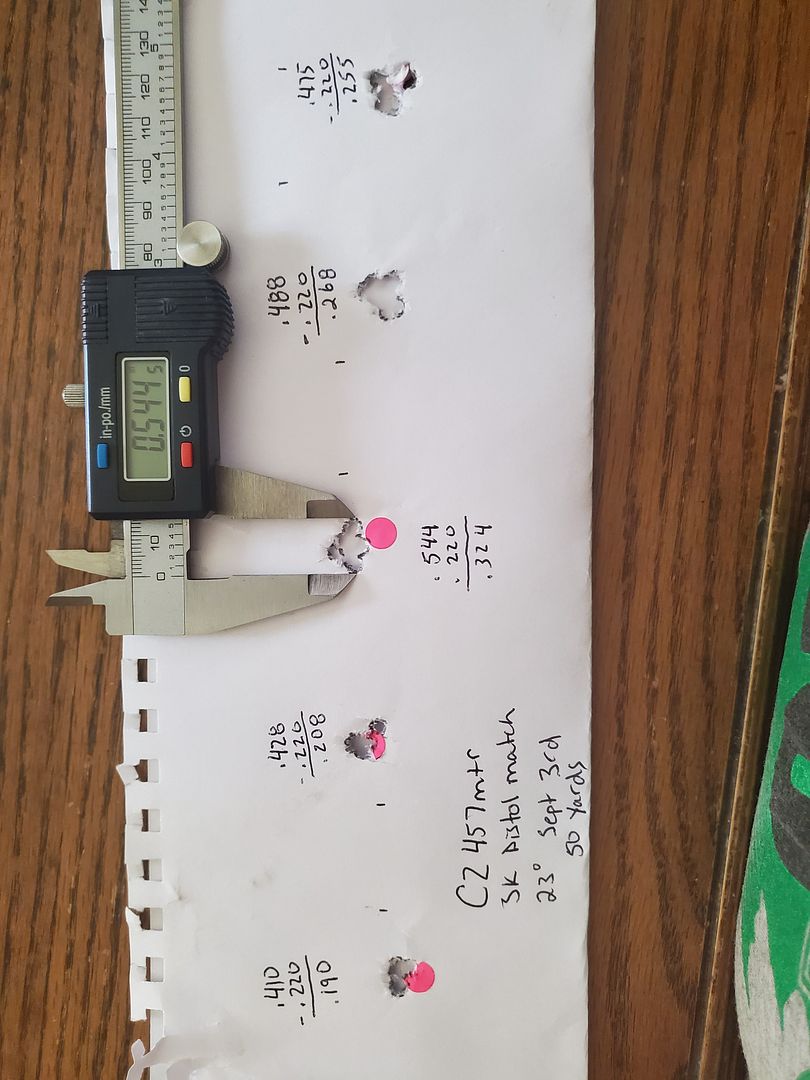

I wish I had seen the post about needing the whole sheet, I usually use 1/4" stickers in a row of 5, 2 rows per sheet and cut it in half. I almost made the 1/4" club today but was the method I described. I will include a pic of the target and if you will accept it I will add the required info. From now on its only 5 stickers per page. I completed the challenge once already using the same rifle and centre x ammo. Today I was using sk pistol match.
Let me know if this qualifies or not and if it does I will add the rest of the info.
