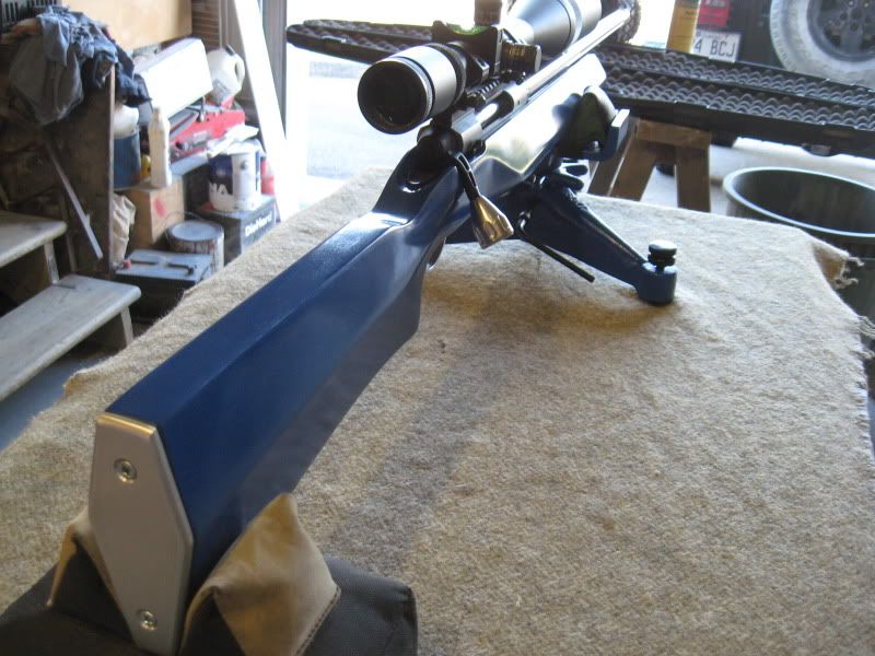

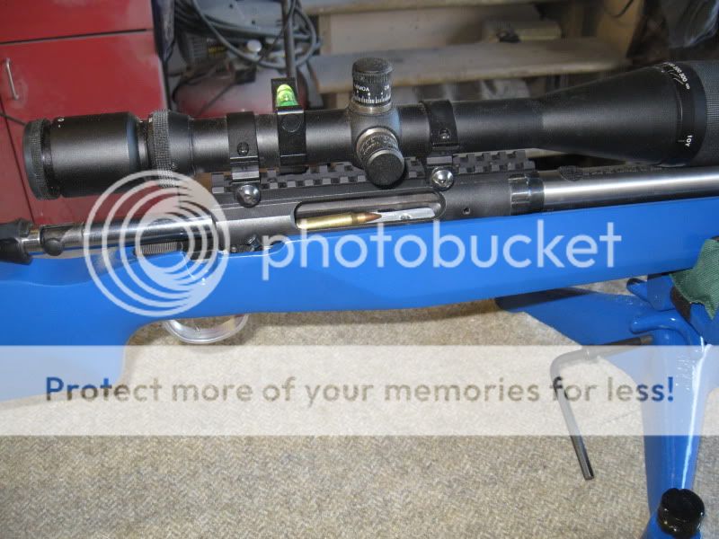

I had a bit of time on my hand during my vacation, and since I will be going to the range once a week for the next two months (100 meter only) I made a benchrest stock for it. It will ride the bag better than the green stock.

Thanks for the comments. Tried the BR stock last Friday. Shooting free recoil is a school in itself, and I found out that the tables at the range are not solid enough, I lay my elbow and with the scope at 32x the crosshair moves. I'll fix the table next week.

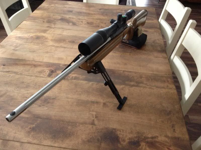

The green stock and the blue BR are bedded, but I am making Axis stocks that are very close.
Things will get more interresting. I bought a 30-06 Axis, found a 308 heavy barrel, so I will make myself a 308 barreled action, with the same 20 MOA EGW scope base.
Since Axis stocks are all the same lenght and shape, this will give me a lot of options to play with. I'll be able to shoot BR in 308 with my 8-32 scope, then I'll be able to install the 223 barreled action into the green stock with my 3-9 scope, then switch the 8-32 scope over to the 223, etc.
All I will have to do is remove the action, change stock, change scope, zero the scope, and shoot.
So, a little update. The Axis 223 now wears a Mpod from Mystic Precision. Today I went to the range (100 meters) to zero the scope. Still very happy with the results. A couple of flyers, I'll see if I can improve my reloading technique.
