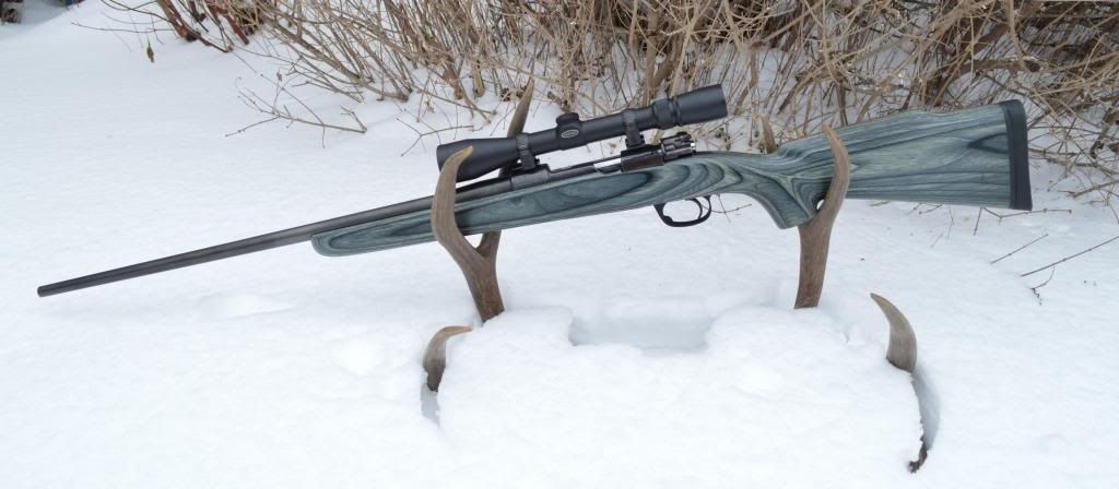

I thought I'd share some pics of the first custom rifle I built by myself. The only work I didn't do was the actual welding of the bolt handle, which I had a professional welder do with a tig. I did the cutting off of the old handle, mounting it in the jig, filing, polishing, etc.
Because it was the first one I did, I just bought one of the cheap short chambered, pre threaded barrels sold under the Brownell's name just in case I managed to screw something up with the finish reaming. It turned out perfect though and shoots under 2moa easily with most loads and right around 1moa with my hunting load using 130gr TSX.
The action started out as a Persian M49 made in the Army's Arms Factory. It had been drilled and tapped before I got the bare action so no historical military firearms were harmed in the making of this rifle. :) Bolt lugs were lapped, bolt face trued, action full length bedded, a commercial cocking piece installed, low swing safety, Bold trigger, and a Parker Hale hinged floor plate was bead blasted and Cera-kote'd. Bolt handle is an Oberndorf style and to be honest not the best design to operate but it gives it a bit of a different look. The stock is a Richards that has been trimmed down with the cheek piece removed.
The scope is a Weaver Classic V 2-10x38 in Burris rings.
I built this several years ago and used it to take a nice mature 4x4 whitetail in 2008.

It shoots fine. Initially I had the barrel free floated and had trouble getting groups less than 1 1/2moa. I've since bedded in a pressure point and now my hunting loads avg right around 1moa or a little better. I haven't actually shot it in a year or so. Too many other projects and new toys on the go but maybe it will get a work out this summer for some target practice.
That's a great looking rifle, well done!! Is it #### on opening or closing and is the action smooth?
Thanks. It's just a standard M98 action so #### on opening. The action is reasonably smooth but really the Persian made action is not as nicely machined as the Czech actions even though it was done with Czech equipment and training.
It feeds and ejects 100% so that's the main thing.

I dont know how I missed this thread, but that is a fine looking rifle!
The colors of the stock and the snow are pretty impressive too.
Something about the colors of winter and mans modern creations...
