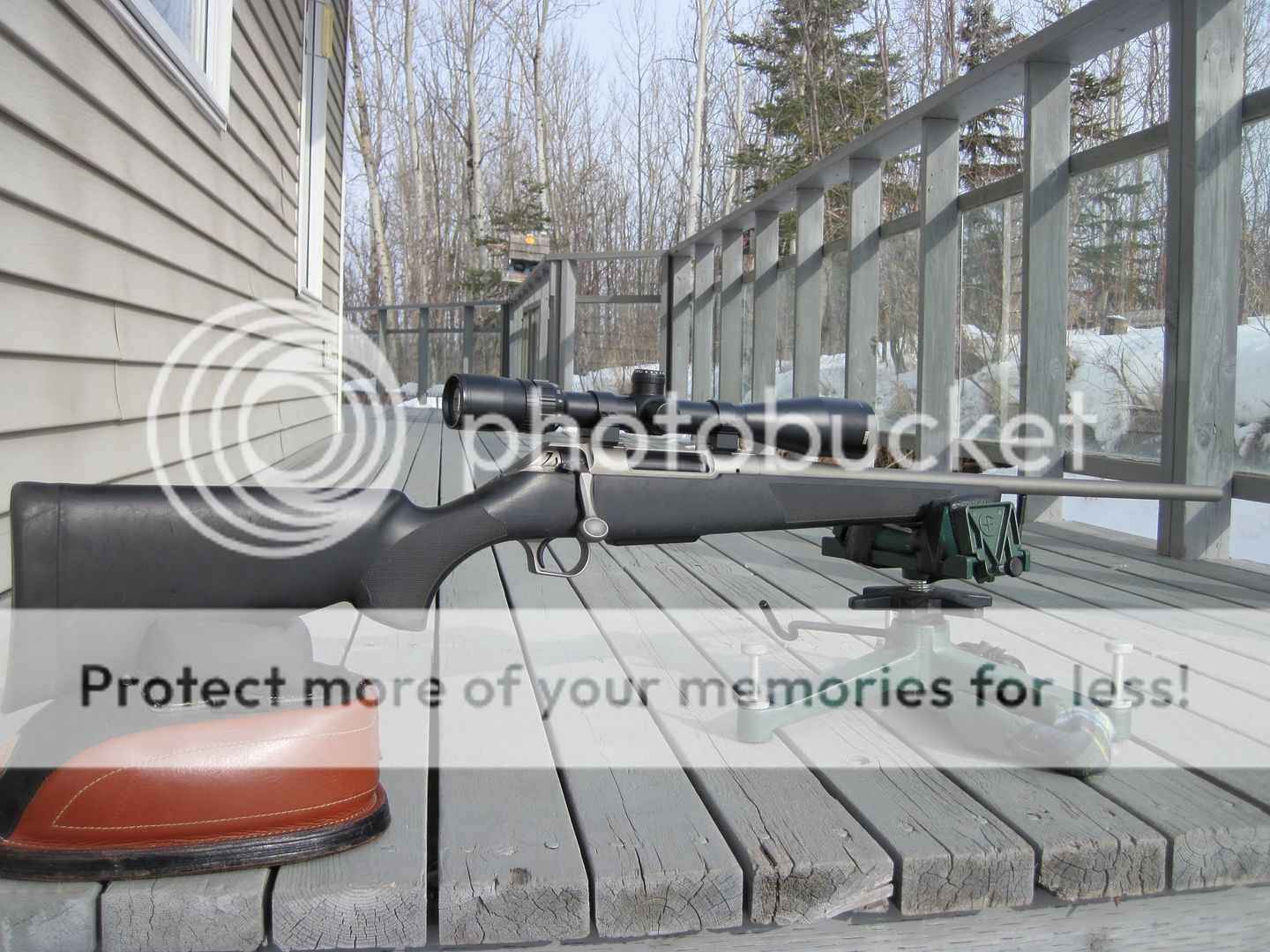

Was at the range on Saturday and gave this challenge a try .how ever I forgot to take my camera with me so the pic of the rifle is taken at home sitting on the bench bags that were used . the rifle is a Stevens 200 223 Rem with a rifle Basix sav 1 trigger added set at 3 lbs .scope is a Vortex diamondback 4-12 x 40mm on weaver rings and bases .the 5 three shot groups were shot without allowing the rifle to cool between groups . 15 consecutive shots .the ammo used was a 40 grain v-max seated on top of H335 cci sr primers and IVI brass .I didn't quite make the challenge but though I would post anyways .group 1 .086" group 2 .648" group 3 .650" group 4 .748" group 5 .827" average group .599" .

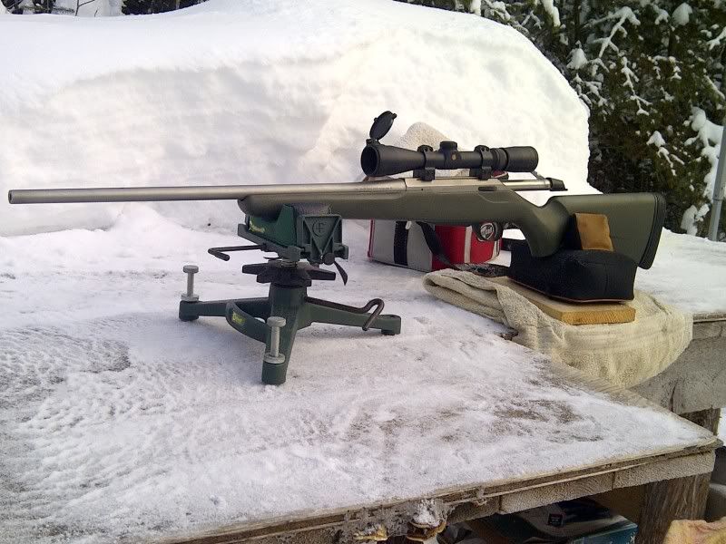

Found the "factory hunting rifle" challenge yesterday so had to give it a try this morning. Did't have enough bullets made up to shoot all the groups with the same load, but it worked OK anyways. Three best groups were shot with 165 Sierra Game kings and the two )left side of target paper) were shot with 168 Brger VLD (H). The Bergers shoot better in warmer weather...but seldom as good as the Game Kings. Temp today was -7C with intermitent light snow and a mild cross wind from behind (a typical hunting day:)

Rifle is out-of-the-box TC ICON Weathershield chambered in 308 Win. I have had 3 Icons, and they all were decent shooters. Scope is Bushnell 4200 4 - 16 X 40.

I must have been posting the pic while you were asking for details..the rifle was sho0t for the "CHALLENGE" as you see it in the pic with a Caldwell Rock front rest and Edgewood rear bag. The Sierra Game Kings are the 165 BTHP in front of 44.0 gr Varget with an OAL of about 2.7" ...brass for these loads was Federal Gold Medal, primers are as always, CCI BR-2. The Berger VLDS are pushed by 43.5 gr Varget, but they obviously need a bit of tuning. They usually shoot about .6"

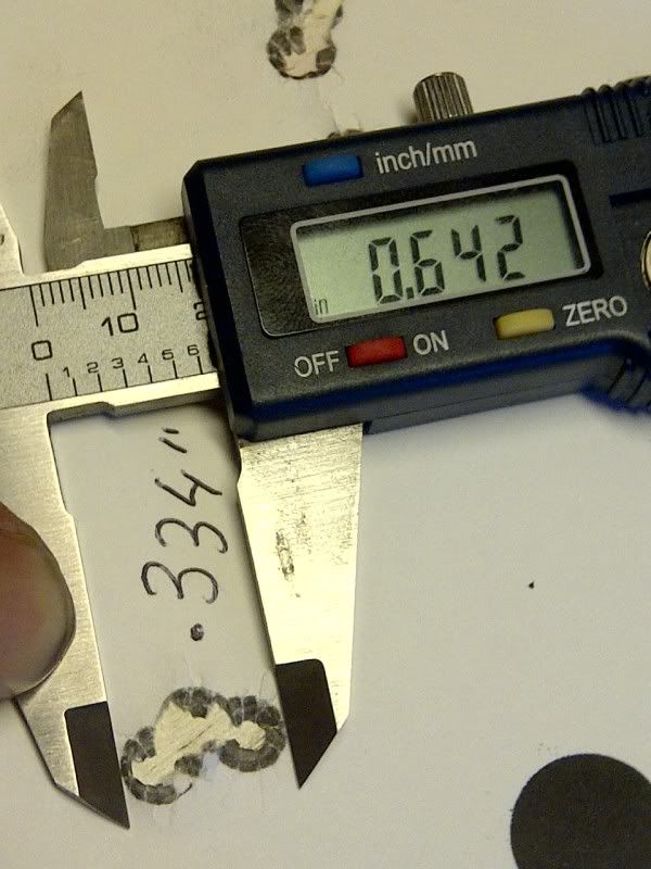

Here is my rifle. It is a Tikka T3 lite 30/06 using 185gr Berger VLD Hunting bullets with IMR 4064 powder.
Here are my groups.
.334" (smallest)

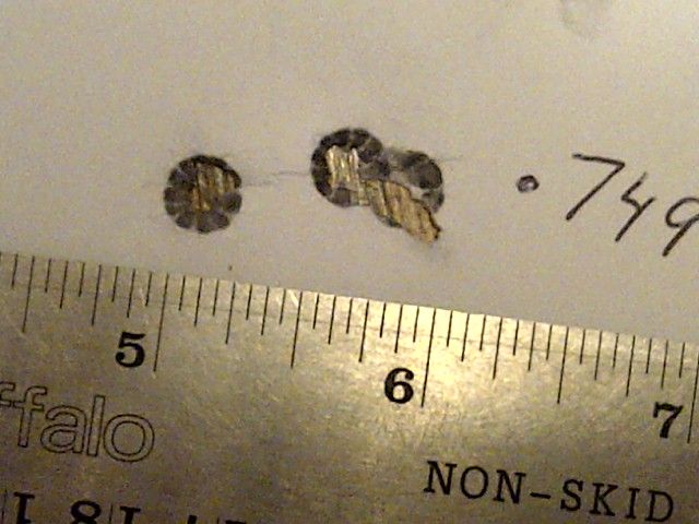

.749" I supplied a pic with a ruler in case anyone wants to check it with On-Target
1.037"
.552"
.638"
.662" average
Here is my small group .642"-.308"=.334"
Here is my .749" group if anyone wants to double check it with On-Target
Great shooting JEC. Congrats on being the first to complete the hunting rifle challenge. I will put your name, and gun info in the original post.
