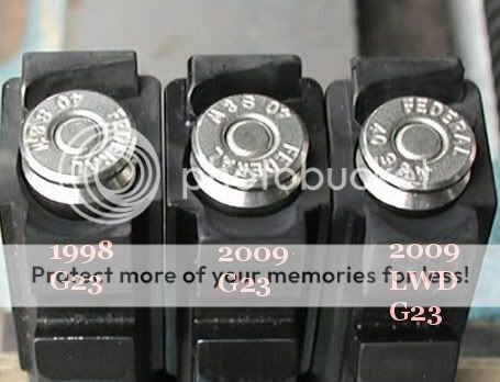

There is more than a little misinformation posted. Here are pictures of three variations of Glock barrels. Note, the Gen 1 was the worst of the three barrels as far as support is concerned. The Gen 3 and Gen 4 barrels are fully supported or as supported as any of my other guns.

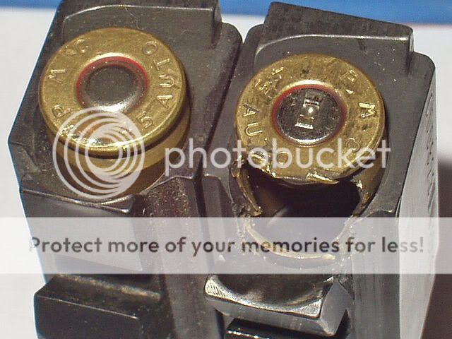

I don't know what caused the case failure exhibited here. If there was no noticeable sound in the discharge then you can almost rule out a double charge though it is not uncommon in a 45acp or at least more easily to go unnoticed. Given the excitement caused by the gun coming apart the noise level increase might easily go unnoticed.
The only other explanation would be an out of battery discharge which is more likely the case given the condition of the case. I had a double charge in a 45acp case years ago and the case let go just above the case webbing but was not near as ruptured towards the case mouth. That was in a 1911. Grips cracked, four bullets in the mag burned off but did not fire in the normal sense of the word and all I got out of it was a blackened hand, a bent ego, and a lesson learned. The noise level was louder but not near twice as loud...just louder. The gun barrel was fine and that was with 10.2 gr of 231, assuming it was a full double charge.
Personally I would rule out a double charge but would not be surprised either if a lab tested the metalurgy and concluded it was. I and we just don;t know.
The case in the picture appears to have ruptured from the webbing to well up the case which would lead me to believe it occurred as a result of firing out of battery. I have no idea what caused that to happen. It could be the striker let go when the father put pressure on the trigger ahead of the slide closing, that might do it. The Glock design is pretty simple with few parts so one can imagine something letting go. Who knows?

Nope.
Judging by the damage and primer being forced back into the firing pin hole, this was an over pressure issue. I don't see what this example has to do with the unsupported chamber?
...? I was answering a question about the fact that Glock has an unsupported chamber...the pics were for visual assistance. Never was it stated that the cause of this kaboom was an unsupported chamber.
As a matter of fact, I advised that he pull his rounds apart. So...I dunno what you're on about Dsiwy?
I misinterpreter the intent of your pics my bad.
It has a flattened primer also indicating an overpressure load. By the pictures this catastrophic failure is non other then an overpressure situation.

I have noticed that brass fired out of a Glock, at least the 9 MM brass usually has a bit of a bulge in the lower part of the case body as some early gen Glock chambers don't fully encompass and support the whole cartridge. As a result I have found brass fired out of a Glock can be difficult to resize without my dies forming a ridge in the case near the case head. This ridge would cause the shell not to fully seat in a chamber.

Not kabooms but early ones had the same chamber issues, hence the "bulge buster" dies on the market.
I don't find a lot of it but when I do, it usually causes FTE's with my SR9. :p
Same here. I am guilty of using range brass and when they come out of my case cleaner and when I go to size I can tell pretty quickly if they were fired out of a Glock or not. I don't have a bulge buster die. When resizing an early gen Glock fired case in my carbide dies you can feel the resistance in the sizer die and if you force it, it will leave a ridge on the side of the case where it is in supported in the Glock. Any case showing this ridge is immediately scrapped as it is almost certain to hang up and not allow your pistol to go into battery.
