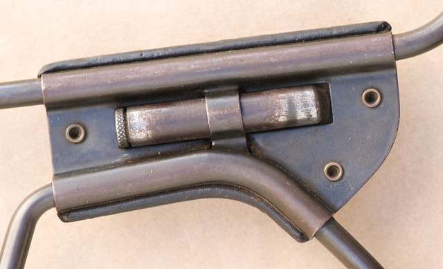

In the end, I'm very happy with it - though it was too expensive - and being left-handed, it's a little less comfortable than a standard wood stock. Very handy though. Nick at Vulcan provided the new barrel, reamed to headspace, and freshly parkerized everything to match.
I also had to replace the reproduction hook portion and retaining bolt of the stock hinge with USGI parts so that the action would not be "sprung" in the repro stock, a common problem with the repro M1A1 wood. If anyone's looking for one of these stocks, be aware some fitting is required. I had to fit the band spring to latch into my barrel band (you need diamond files to cut into the spring steel), I had to shorten the front handguard to be a tight fit between the barrel band and the front of the receiver. I also had to slightly inlet the wood under the rear of the receiver to allow the action to fully seat.

Another item to note, ALL the repro M1A1 stock hand guards I've seen had poorly-installed aluminum hollow rivets. I had a spare cracked M1 carbine 4-rivet handguard, so I punched out the crappy aluminum hollow rivets and threw-away the poorly made blued steel retainer clip and replaced them with re-used original solid steel GI rivets and a GI parkerized retainer clip. HUGE improvement in looks.
If you've never handled or shot an M1A1, I strongly recommend looking for an opportunity. These rigs are just too handy to be believed. And when Non-restricted, it's hard to imagine a better bush carbine.
