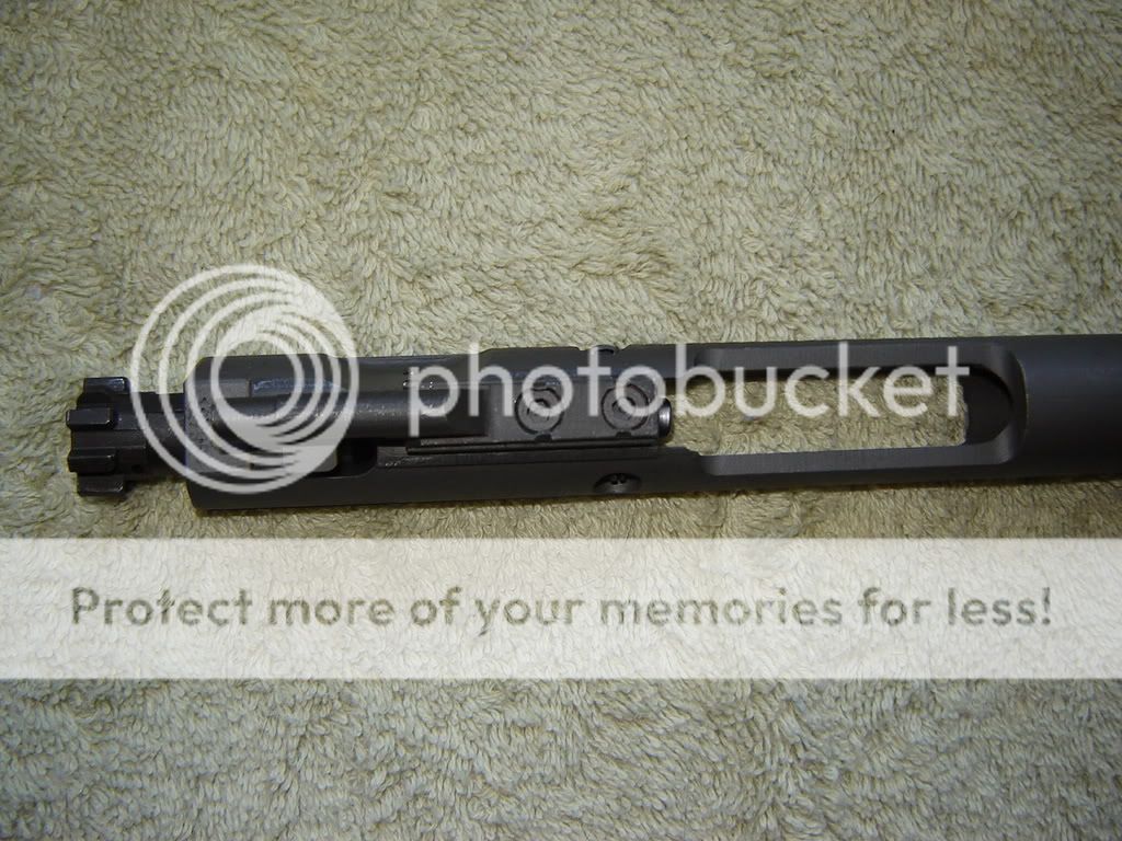

FWIW none of the NEA BCGs I have seen (physically or on this forum) have been staked anywhere near as well as my Norc BCG.
Can you throw up a pic? I'd like to see the difference.

The bolts are torqued to 56ft/lb at assembly and require an average of 82ft/lb torque to remove with the staking. It is sufficient.
The majority of our carriers are not staked in this manner, but have been inspected/tested.

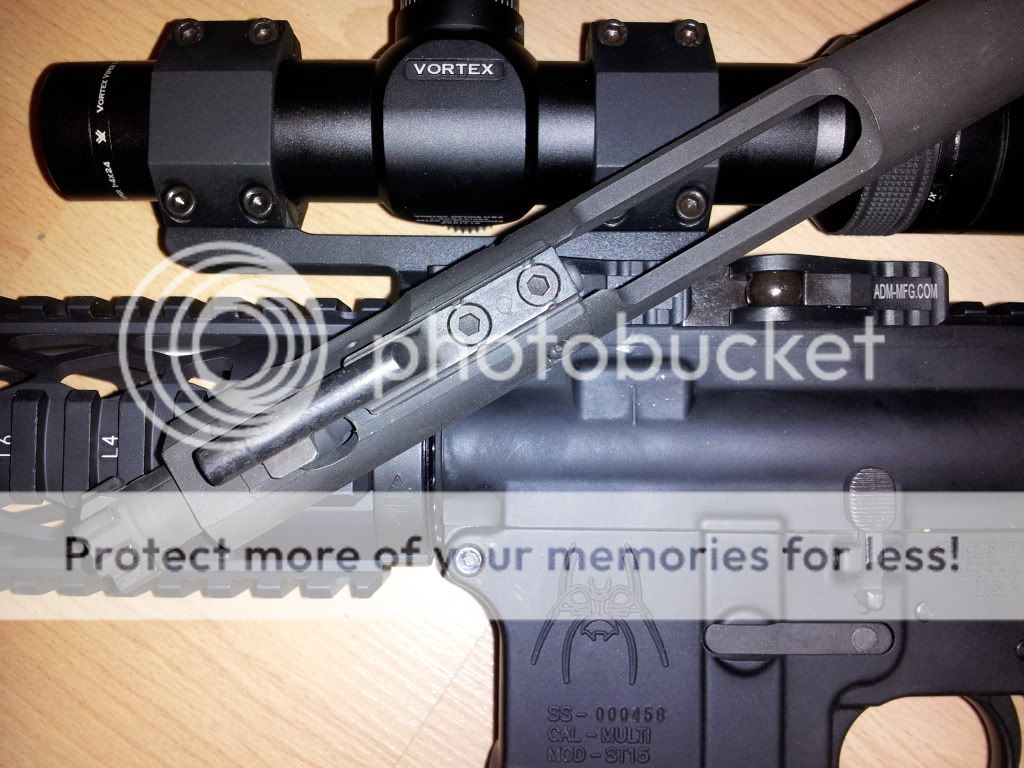

Here is a picture of my LMT bolt
holy frack... NEA already stated that it requires MORE torque for those screws to back out than they did going in... so that means they are staked properly folks.
I'm AME by trade and that is all we do, stake to ensure that the bolt/screw will not back off under NORMAL OPERATING CONDITIONS. You do NOT stake so much that the surrounding metal is folded over top the bolt/screw and you deform the bolt/screw so you will never get it back out again without damaging whatever the screw happened to be securing.
