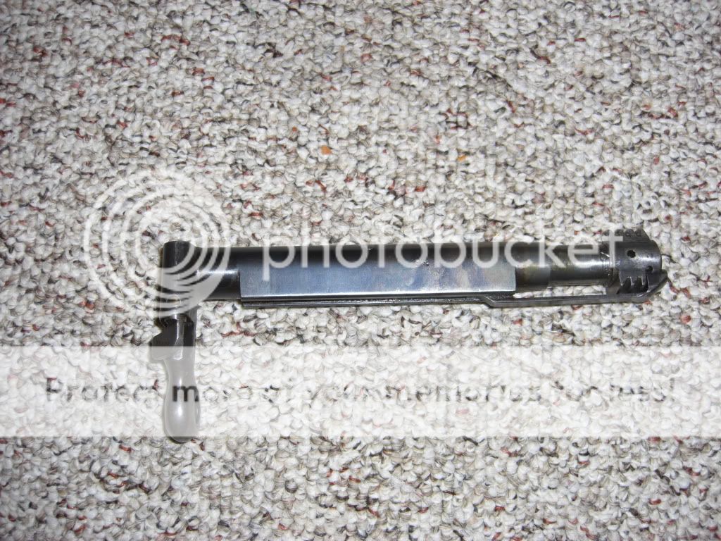

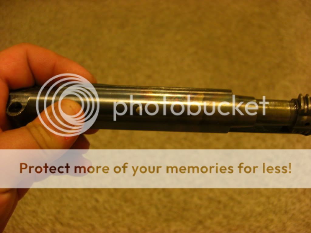

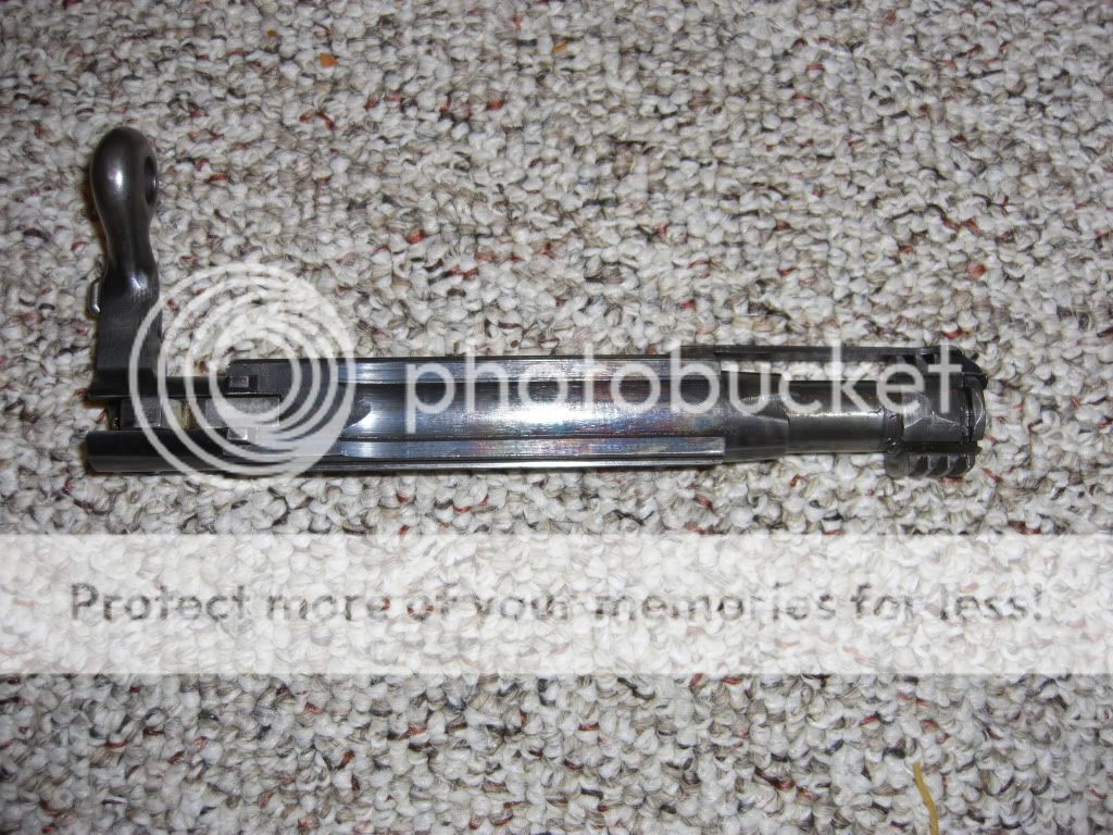

Now I hoping someone can tell me if the bolt is put together properly. When you go to put it back in the action its a bit of a trick to do. The head wants to snap into the locked position. Is this right? Is the pin on the side, the pin someones put it to keep it assembled right:confused: Any help would be great.
When the bolt closes the head rotates clockwise if you looking at the chamber.

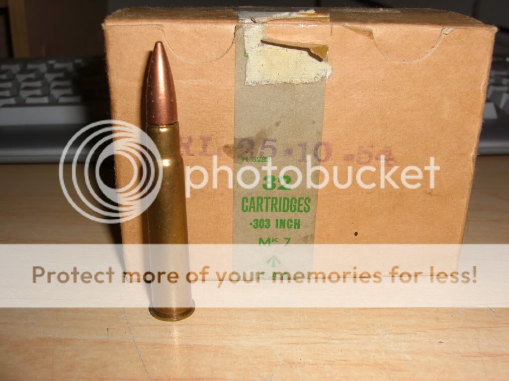

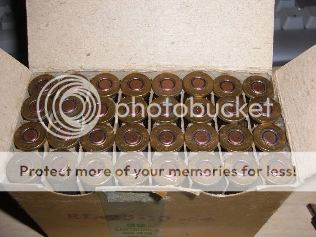

The other week I stop into the local store and what do they have? Surplus .303 brit for a decent price. $14 for 32rounds. Ok Ill take all ya got. Then I see 15round boxes of soft point for $6. Not a bad day :D

Yes, your Ross Mk III action has a pinned bolt. It should be virtually impossible to put it in the rifle wrong.
The bolt is in very nice shape with the case hardened finish looking like new. Does this rifle have a serial number on the left of the barrel/action? Or is it registered using a black sticker and FIN number? (don't say what the numbers are)

Your bolt exhibits what can be called normal behavior for a bolt of this type.

Kyle- do us a favour. If you've never fired a Ross before...as you push the bolt ahead, the gas relief hole should be facing up, there should be the width of your thumb between the bolt shroud and the bolt head, and you should watch the bolt rotating into lockup in the last bit of travel. You can also use a cleaning rod or similar to push down into the barrel muzzle, back against the bolt to ensure it's locked.

Oh yeah...consider that ammunition corrosive, which means clean the barrel with Windex or similar shortly after firing, and once home a kettle of boiling water down the bore from the breech wouldn't be amiss.

Thanks cantom, I tried the cleaning rod thing already. Just wanted some more oppinions on the bolt.Don't feel like having it pass throught my shoulder.
I figured all the mill surp ammo would be corrosive. Not a big deal for me.
