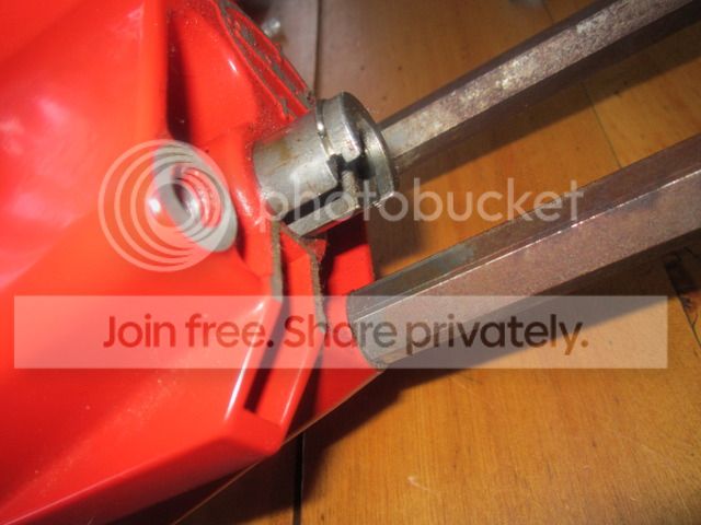

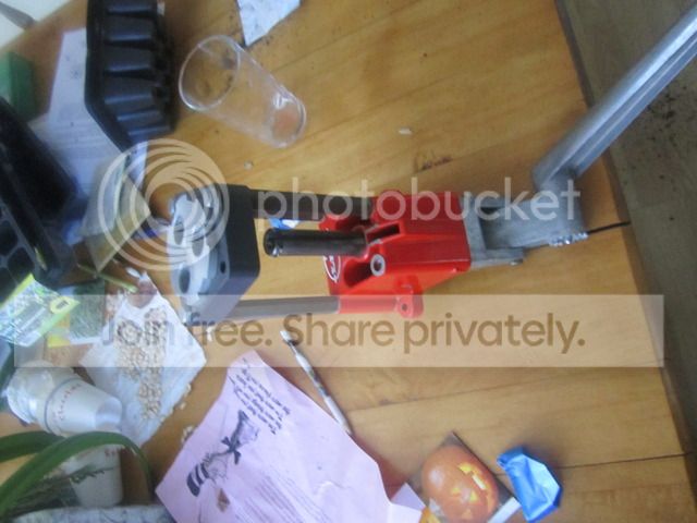

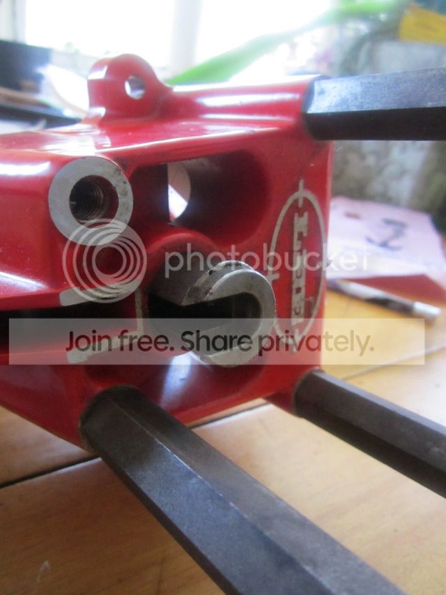

My new (used) press appears to be missing something!
If the Ram normally has the shell carrier (which align with the turret) would it align with a single hole without it?
EDIT:
Have been going between part lists for pro 1000, and the 3 ring turret.
Part numbers for base (tp2125) , and top ring (tp2126) are the same.
It would seem a ram replacement (TP2107), and confirmation of column height (possible column replacement) would allow for use as a manual indexing 3 hole turret.
My 3 hole turret press columns are 4 1/4 inches long(not including threads!) measured bewteen the base, and top plate.
Even if you got the proper ram to load rifle cases you would not be able to size 30-06 length cases as the opening will only accommodate maximum length 2.3" loaded rounds, if you are on a tight budget as many of us were when we started out look for a used single stage press. If you can't return this press to the seller advertise it on the EE with a pic, you should easily be able to get your money back.
For the price of it, i think ill keep it for now and start looking for a single stage press. That is what i was looking for originally until i came across (what i thought was a turret press). The columns on mine are just a hair longer than 5", so i think i will order a 3 hole turret ram and three new columns for a turret press. If the pricing at higginsons is the same as the lee website it should cost less the $20 to have a non indexing three hole turret set-up for future reloading.
